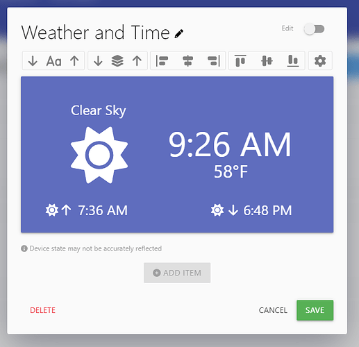

I suppose I'm just looking for a basic 24 hour clock hh:mm, so that when I pop it on a SharpTools tile I can get it to match my normal clock.
Can you clarify all the content you'd like to see in your tile at once? You might be able to use a SharpTools Super Tile to mix and match the content you're looking for.
The clock elements in the Super Tile would pickup your system locale and display it in your regional time format or you could customize it as you see fit:
For sunrise/sunset, if you already have a driver that has that information, you could pull it from there. Otherwise there are sunset/sunrise APIs and I could guide you through that if needed. :slight_smile:

Yeah my plan is probably to use a Super Tile rather than individual tiles. It looks as though the 'Hub Information Driver' that @thebearmay created will be able to grab the sunrise and sunset times for my location from the hub once updated. I'll then add those to a Super Tile via the 'Hub Information Driver' virtual device, selecting the Hero attribute layout and 'sunrise' / 'sunset' as the primary attribute for the device. I've used this driver to put the 'Hub Free Memory' in a SharpTools tile already.
