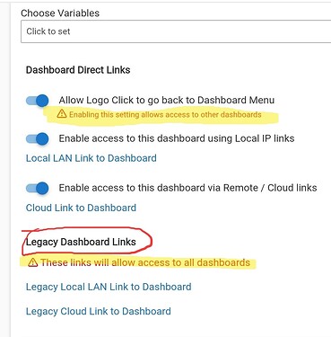

I am using the Legacy Dashboard links on my iPhone. They provide me with the status of my devices. I would like the access to my devices to be somewhat secure, but really, if someone gained access, all they could do was turn lights on and off.
What is difference between Legacy and New? Should I change to new?

ALL of my current dashboards have links that can either be legacy or new. The newer support more security. But, that is just the links to access them. The dashboards are the same regardless. I prefer legacy because it was easier to use links to other dashboards. The big security thing was disallowing links to other dashboards which could allow someone to get into any dashboard you have.

The "new" links allow you to prevent using the logo button to see other dashboards and I think prevent directly linking other dashboards in the same way that the legacy ones did. Again, it has been long enough ago, I do not recall the specifics. But my memory was that you had to set up the links differently for them to open.
I just know you could give someone a link to the new dashboards that doesn't have a login, and let them have access to ONLY that dashboard (So kids - visitors - in-laws, etc)
