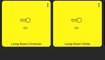

I have searched through the threads and have not found an answer to my "issue". I would like to have the active app I'm running "lightup" as on, and the other apps that control the same devices show as off.
I'm using the standard dashboard, not the EZ, and have a C7 hub.
Single On
This photo shows I have two apps for my living room lights. The Christmas one is on and running.
Both On
If I select the winter tile, both tiles stay lite up as on. I would like to have when I select the winter tile, while the Christmas tile is active to have the Winter tile show as on, and the Christmas tile to show as off, and visa versa.
Pardon my ignorance on this subject as I have to believe this can be done, yet I can't rap my head around it.
Thanks in advance.
The tiles only show what the device is reporting, i.e. if you want the tile to show off, turn off the device. Assuming this is a set of virtual switches, the simplest solution is a rule that turns one off it the other turns on.
Thanks...yes that is the situation. I will play with the rules....thanks again.
