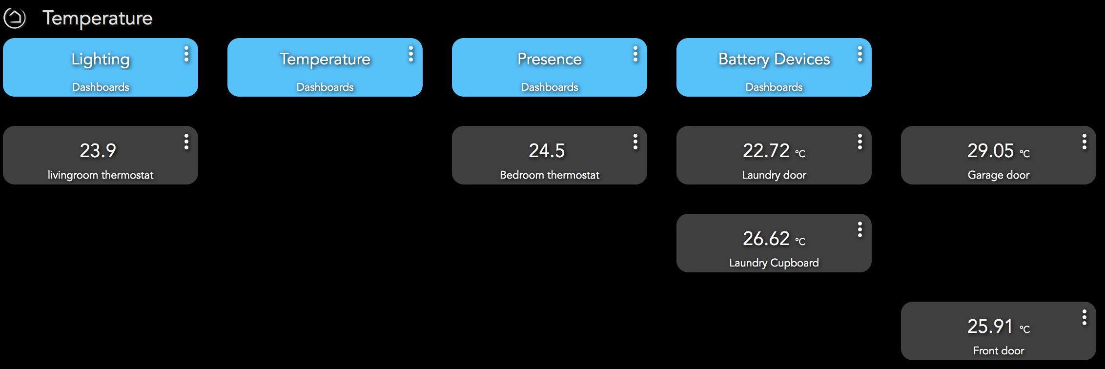

hey y'all,
with the battery tiles they are RED when they are under 10%, is there anyway I can set the stock temp tile to do the same >35c red, <35 like green ?

Although were you talking about batteries or temperature? The title says Dashboard Temperature and that is what the picture shows however the description asks about batteries.
Just asking about default temp tiles to have a similar behaviour to battery default tiles and if thats possible. Say if I left a heater on in my daughters room I could check the temp visually and see it was red to then investigate (yeah I realise I could set a notification of >35 send a push message) Was just to make it nicer looking. if we could set the default state for 2 or 3 temp ranges that would be great.

But the layout I have currently is close to the actual rooms of my house so I can see the whole floorplan and the temp in each room.
