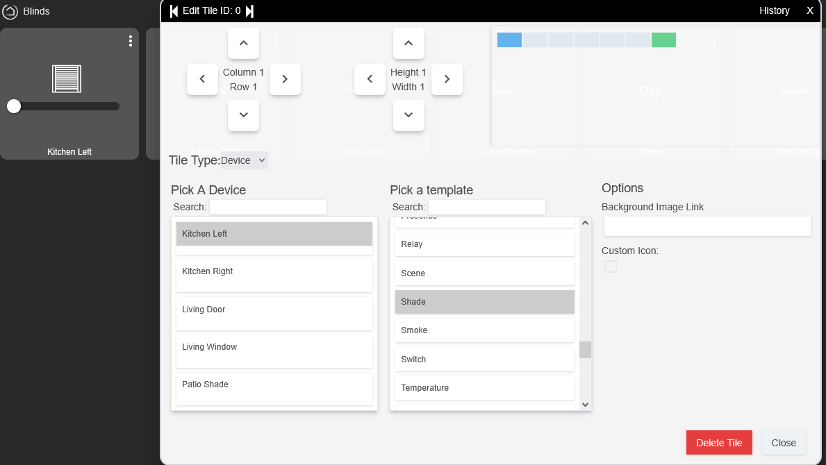

My first projects is to set up control of my somfy shades using a Bond Bridge and the Bond Integration. The shades are evident as child devices and I can see for each open/close commands although not yet worked out how to establish the My position. However, when I try and create a dashboard to control them I cannot access any commands let alone the open/close.
I have tried both the Easy Dashboard where all I get is
as well as the older Hubitat dashboard
Neither includes any open/close commands.

So, I have this same setup. They work for me under the regular dashboard, just not the EZ dashboard. I also get the sad face. I imagine if you created a virtual switch and made an automation to open/close based on the state of the virtual switch it would then work on EZ dashboard. Coming from actiontiles/smartiles EZ dashboard just doesn't do what I want anyway, and I just took the time to set up a dashboard based on the built in tools and set up the thematic elements the way I want.
