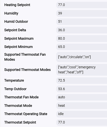

Conclusion
I am clearly floundering, but do have the thermostat reading with no errors. Can't say with any certainty that all my modifications are either required or smart, so you know, be warned.
I think I figured out @srj.little's notes and made one edit of my own - (Added off tmode in Thermostat mode to setThermostatMode function so that the dashboard could set off mode: line 409-410). See the full driver code below. Everything is working great for me! Thanks to @srj.little @MikeSas @woodard.thomas and everyone else who worked on this!
Reminder that you need to populate line 28,29,30 with APIkey, email address, and integrator token.

I just installed a Daikin one+ stat into my communicating system.
All functions work great with the stat AND HE.
The ONLY thing missing is to be able to control fan speed from HE either by a dashboard switch / button or in RM.
I can on the stat and HE does indicate what the fan speed is, but there is NO WAY to control it.
I know the stat has"airquality" / "recirculate", but I haven't found a way to just run the fan other than setting the schedule for recirculate.
Unless I am missing something, how can I do this.
I would like to be able to set the speed in rule machine also, but I cannot find the parameter.
Thanks!

I did find that I am able to change the fan mode, but what I would ALSO like to do is change the fan SPEED.
I am guessing that this is not a parameter that can be set, but only monitored as in the device page, fan speed is listed.
Also, why is Fan listed as False in current states?
Another thing....
When the stat is heating, the device page indicates IDLE and NOT heating.
Any ideas? @thebearmay
May be the poll timing, i.e. the heating is occurring between the polls for status.
Sorry, I wasn't notified of your response...
Anyway, would the status change on the next poll?
I have the poll set at 3 minutes right now.
If I changed to 1 minute would that trigger something on Daikin's servers?
I assume this integration is cloud based (YECH)!
OOPS... yes it does work and I can control the fan on/off/circulate.
I would also like to control speeds though, but haven't found a way to do that other than on the stat itself....
