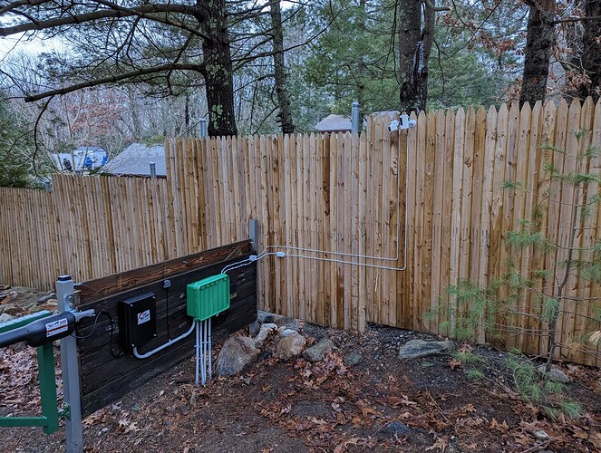

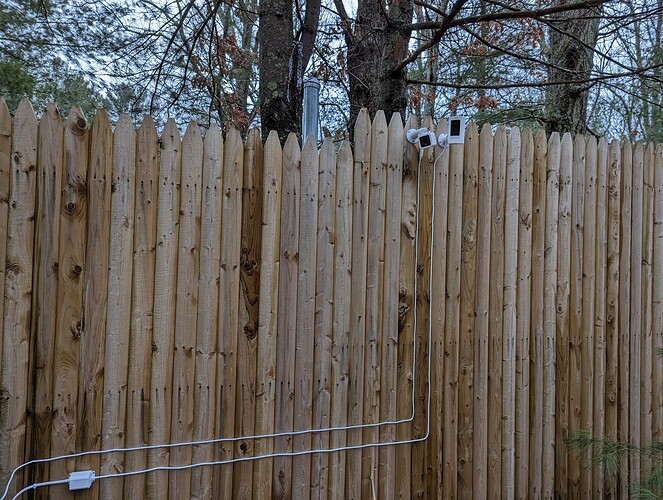

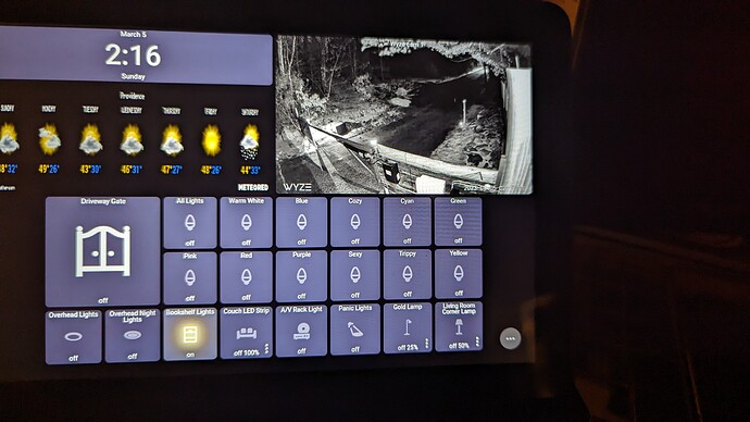

Currently I have a WYZE cam running to Tiny Cam Pro on an always plugged in the Android phone. This creates a web link to the video which i can then create a tile for an action tiles and get video feed on my dashboard. I then have a Ring camera right next to said Wyze cam for motion alerts. Absolute madness but it works pretty well.
Are you telling me I can take one of my Armrest POE cameras and this app and basically take care of what I'm trying to accomplish with the two cameras? This would be amazing if I was able to get it to work. I can get POE down at the gate. Currently have a WAP serving a Shelly wifi relay to trigger the gate via dashboard. I bought a second C7 and was going to run ethernet down there and hub mesh to get some zigbee and Z-Wave coverage so I will have POE down there.
Scenario: 500'+ driveway through the woods down to a driveway gate at the road. Camera keeps an eye on the driveway gate and package box. The Ring camera is just set up for alerts for when motion comes by.
