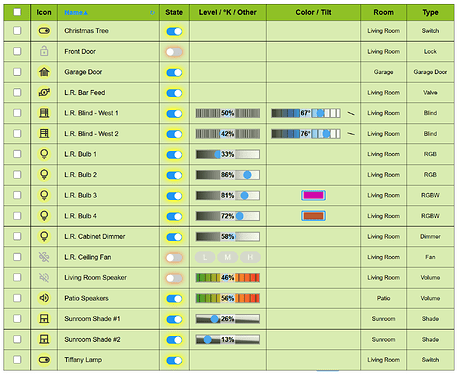

Check out my remote builder code, specifically SmartGrid which is shown below.
Bi-directional communication between a JS app and the Hub with the app being embedded in the Groovy app and being delivered over an endpoint.
You can play with a live version here using virtual devices on my old C-5..

This was my JSON upload to the hub from changing 1 parameter on 5 devices simultaneously.
Uploading device data via toHub(): [{"dID":"2824","switch":"off"},{"dID":"2822","switch":"off"},{"dID":"2825","switch":"off"},{"dID":"2823","switch":"off"},{"dID":"2814","switch":"off"}]
So changing 5 parameters on 20 devices would be very manageable using JSON IMO if that is truly the upper edge use case.

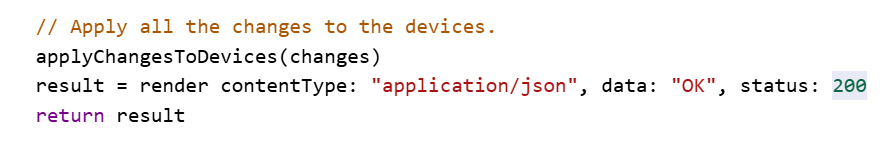

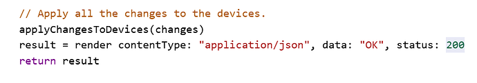

Okay...after doing yet more digging, it appears that there is no way to get a response from a GET or POST request. The simple reason is that there is no way to white list a client for a custom app in Hubitat (or, at least I can't find it). Because of that, all the response information is hidden from the script when the browser gets it.
When you do a POST of data from the JS to the Hub and the Hub processes whatever is received, then you have to do a second render back to the JS and include the status code you want to return.
I kept mine simple but it could be more nuanced.
If the client is delivered over the endpoint then CORS does not apply and you don't need to do anything with it.
