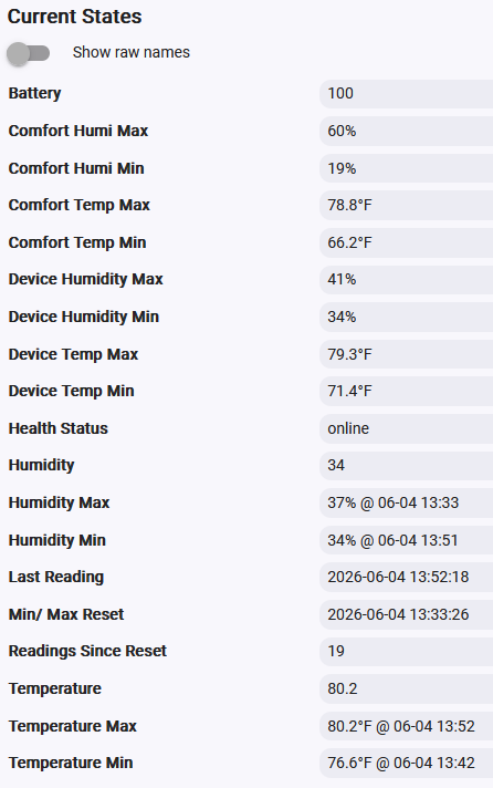

Sonoff SNZB-02DR2 AirGuard TH β€” Hubitat Driver
Driver version: 1.12.2
Device: Sonoff SNZB-02DR2 ("AirGuard TH") Zigbee temperature and humidity sensor
Manufacturer/Model strings: SONOFF / SNZB-02DR2 or eWeLink / SNZB-02DR2
Firmware: Software Build ID 1.0.2, Date Code 20251020, ZCL version 3, HW version 16
Manufacturer code: 0x1286 = SHENZHEN COOLKIT (Sonoff/eWeLink)
Overview
The SNZB-02DR2 is a Zigbee sleepy end-device with a 3.6" LCD display showing current temperature, current humidity, 24-hour min/max extremes, comfort zone icons, and battery level. It uses a mix of standard Zigbee clusters and Sonoff's private FC11 and FC57 clusters for extended features.
This driver was developed through iterative Zigbee sniffing using the Knockturn Alley diagnostic driver. Several of the FC11 attributes described below were not previously documented for this specific device, and some behaviours remain under investigation.

Device Characteristics
Property Value
Logical type Zigbee End Device (ZED) β€” not a router
Sleepy device Receiver off when idle; wakes to report then sleeps
Check-in interval 29 minutes (0x00001B30 = 1740 seconds)
Long poll interval 1740 seconds (same as check-in)
Short poll interval 1 second (while awake / fast polling)
Fast poll timeout 10 seconds after wake
Max buffer size 74 bytes
Physical sensor range βˆ’40Β°C to 115Β°C / battery reports 27–29 min cycle
Check-in vs. reporting: The 29-minute check-in / long-poll interval controls how often the device listens for messages from the hub β€” which is why writes must be sent while the device is awake. It does not limit how often the device sends readings: temperature and humidity reports are pushed whenever the change exceeds the reporting threshold (subject to the minimum interval), plus a heartbeat at the maximum interval. See FAQ below.
Health check note: With a 29-minute check-in interval, the driver's health check (which fires every 3 hours and marks offline after 4 missed cycles) gives the device approximately 2 hours of grace before being flagged offline. This is appropriate for normal operation but means the device will not be marked offline quickly after a battery failure or signal loss.

Device-native 24-hour min/max (confirmed via Zigbee sniff)
These come directly from the device firmware via FC11 cluster attributes 0x2008–0x200D. They are the same values shown on the LCD display. The device pushes these unsolicited roughly once per hour; Refresh while awake also reads them explicitly.
Attribute FC11 Attr Type Notes
Device Temp Max 0x2008 INT16 Γ—100 Β°C
Device Temp Min 0x2009 INT16 Γ—100 Β°C
Device Humidity Max 0x200B UINT16 Γ—100 %
Device Humidity Min 0x200C UINT16 Γ—100 %
Note: Attributes 0x200A (reference temp) and 0x200D (reference humidity) also arrive in the hourly burst. Their meaning is unconfirmed β€” logged at info level but not exposed as Current States.

Comfort zone thresholds and LCD unit
Reflect what is currently programmed in the device firmware. Read from FC11 on every Refresh and on Configure/Initialize.
Attribute FC11 Attr Notes
comfortTempMin 0x0004 :snowflake: icon threshold
comfortTempMax 0x0003 :fire: icon threshold
comfortHumiMin 0x0005 Lower humidity comfort bound
comfortHumiMax 0x0006 Upper humidity comfort bound
lcdTempUnit 0x0007 Celsius or Fahrenheit β€” unit the device's LCD is actually using (read back after every Save), not the preference (new in 1.11.0)
Note: FC11 comfort threshold attributes (0x0003–0x0006) and device min/max attributes (0x2008–0x200D) do not appear in FC11's attribute discovery response. They are only accessible via direct read with manufacturer code 0x1286, or received as unsolicited reports. This is why standard Zigbee tools cannot see them without the manufacturer code.

Important note on discoverability: FC11 comfort threshold attributes (0x0003–0x0006) and device min/max attributes (0x2008–0x200D) do not appear in FC11's ZCL attribute discovery response. Only 0x0007, 0x200E, and 0x600E are discoverable. The remaining attributes are accessible only via direct reads using manufacturer code 0x1286, or received as unsolicited reports from the device.
Attribute Type R/W Status Description
0x0003 INT16 R/W Confirmed working Comfort temp max (:fire: threshold), Β°C Γ—100
0x0004 INT16 R/W Confirmed working Comfort temp min (:snowflake: threshold), Β°C Γ—100
0x0005 UINT16 R/W Confirmed working Comfort humidity min, % Γ—100
0x0006 UINT16 R/W Confirmed working Comfort humidity max, % Γ—100
0x0007 UINT16 R/W Confirmed working (write fixed in 1.12.2) LCD temperature unit (0=Β°C, 1=Β°F); exposed as lcdTempUnit. Device reports type 0x21; rejects UINT8 writes (0x8D)
0x2003 INT16 R/W? Not yet observed Temperature calibration offset, Β°C Γ—100
0x2004 INT16 R/W? Not yet observed Humidity calibration offset, % Γ—100
0x2008 INT16 R only Confirmed working Device max temp (24-hr), Β°C Γ—100
0x2009 INT16 R only Confirmed working Device min temp (24-hr), Β°C Γ—100
0x200A INT16 R only Received, meaning unknown Reference/previous-period temp
0x200B UINT16 R only Confirmed working Device max humidity (24-hr), % Γ—100
0x200C UINT16 R only Confirmed working Device min humidity (24-hr), % Γ—100
0x200D UINT16 R only Received, meaning unknown Reference/previous-period humidity
0x200E UINT8 R only? Newly discovered, discoverable, value=0 Unknown β€” sent in wake burst
0x600E UINT8 R only? Newly discovered, discoverable, value=0 Unknown β€” sent in wake burst
