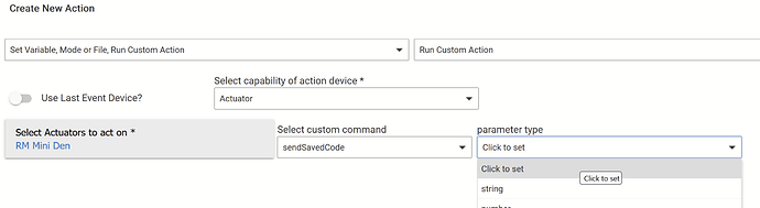

This command declaration format works for me with Rule Machine from one of my custom drivers.
command "sendSavedCode", [[name: "name*", type: "STRING"], [name: "reps", type: "NUMBER"]]
Are you able to select your device but the command just is not listed? Or you're not able to select the device at all, potentially because it is missing one of the built-in capabilities (I typically use Actuator if another capability isn't applicable).

Maybe add the actuator capability? It is a most useful "catch all".
That was exactly what is needed!
