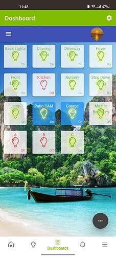

This is my customized dashboard through sharptools

Yes, by going directly to the sharptools website, I am able to control all of the apps. If connected to my network, the sharptools customized dashboard will display. Once disconnected, the hubitat app will only display the hubitat dashboard
