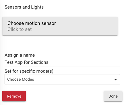

I'm noticing something odd, too. The code you provided in your example above demonstrates this, rendering differently for me on 2.3.3 than on 2.3.4 on two different hubs (ignore the slight difference in sizing). Using a pared-down version of an app I wrote for the docs a while back, I also see the same:
2.3.4 (note that there is no section title):
Screenshot 2022-12-08 at 3.47.39 PM
2.3.3 (section title displayed as expected):
Screenshot 2022-12-08 at 3.43.14 PM
I'm guessing most people haven't noticed this since lots of apps either use multiple pages or explicitly define them instead of relying on the simple single-page behavior, but this was probably an accident.
