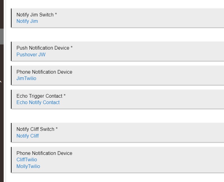

Have several custom apps. Went to change one of the selected items and noticed the preference titles are missing. Checked several other apps and same thing. What happened? Here is what i am seeing.
Anybody got any ideas on this? It is a major problem for me. All my apps are doing it and it just started with maybe the last, or the one before that, hub update.

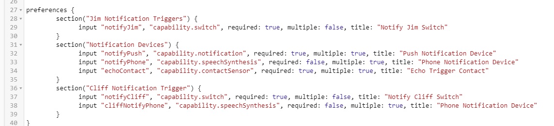

In the app code where it says section("something here") that is the title for each section of preferences. That title should show up above each section of inputs in the app configure. And they always have before.

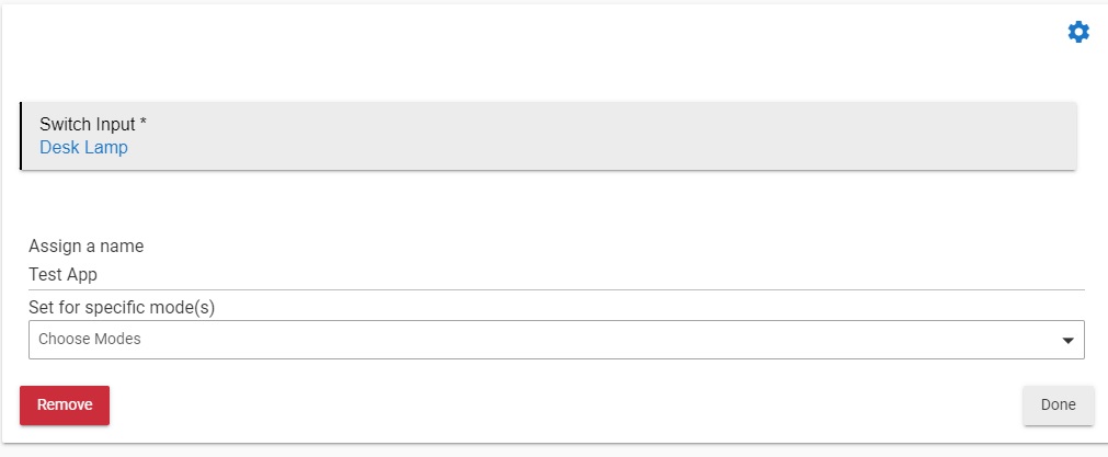

I created a simple app to test. It has the same problem. Here is the code and a screen shot of the app. There must be some setting somewhere that isn't allowing those titles to show up. Maybe a color setting??? If the title is white then it wouldn't show up on a white background. But I don't know anyway to change that.

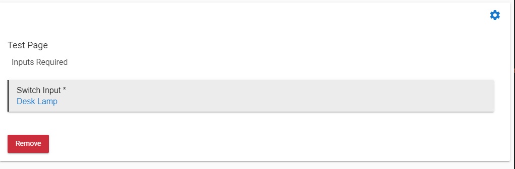

Playing around with stuff, if I add a page reference enclosing the preferences it works. Wish someone could tell me why I need that when I didn't use to need it.
Here is what I added:
page(name: "page1", title: "Test Page", install: true, uninstall: true) {
Here is the new app look.
Hate to keep belaboring this, but sure would like to find out what is going wrong. I realize I found a work around, but don't know why that would be needed.
