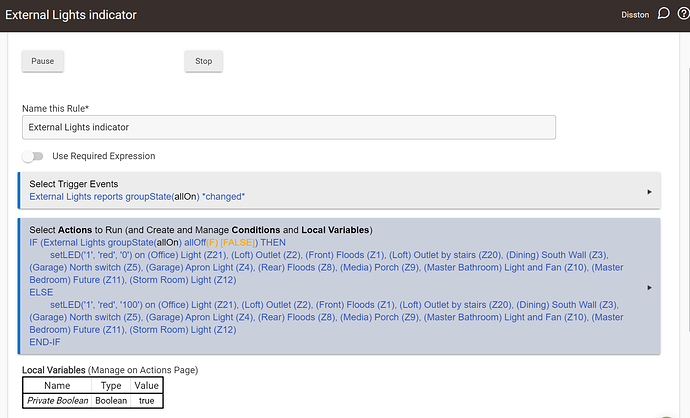

Hi @bravenel think i have found a issue with custom trigger and custom actions.
eventually managed to get it to trigger but the actions just wont run?
all logging is enabled and this is all i get
As soon as a changed the trigger to a switch, it worked.
Able to reproduce...

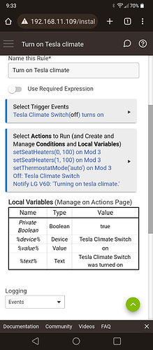

I have custom actions in my tesla driver and use alexa to fire it when i tell.her to turn the heat on
. It is working fine?
Maybe setThermostatMode is not a custom action but a built.in action? And the seat heater setting is not working and i didnt notice?
Not the same case at all.
If u say so
.. i read he couldn't get custom actions to run.
They didn't run because the rule was not triggered.
This bug found and fixed (failure to trigger from Custom Attribute changed). Had to do with Custom Attribute changed for certain attributes.
