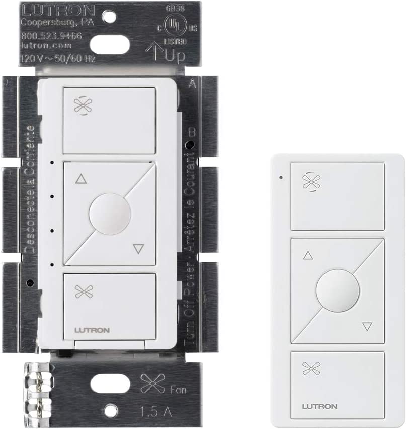

Are the Lutron fan switches Lutron Caseta? If so, you will need a Lutron PRO hub. You then pair the switches to the Lutron hub and use the Lutron integration to control them all from HE. It works GREAT and many of us here are huge Caseta fans. I have a couple of fan switches and about 30 regular wall switches.

Lutron Caseta Fan Controllers, Dimmers, Switches, and Pico Remotes all require the Lutron Caseta SmartBridge Pro2 in order to be used with Hubitat.
If your Fan controllers are working, without a SmartBridge Pro, then they are not Lutron devices. It sounds like they are Z-Wave or Zigbee devices instead. Perhaps Leviton is the manufacturer? Or GE?

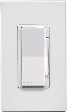

As @ogiewon pointed out, your fan switches are probably Leviton fan controllers. These are z-wave+ devices that can pair directly to Hubitat. This is what they look like:
Lutron Caséta Fan switches use a protocol called ClearConnect for which Hubitat doesn't have a radio. So they only work with the Caséta Smart Bridge Pro, and cannot pair directly with Hubitat. They also look quite different from the Leviton fan controller. This is what the Lutron Caséta fan control looks like:

You are correct! Leviton!! Not lutron! :person_facepalming:t3: I always want to call them lutron ... I looked at lots of stuff before getting them and it all runs together after a while.

And sorry for confusing the lutron and Leviton names. It is definitely the Leviton. I have 2 of them. I edited the original post to reflect accurately.
