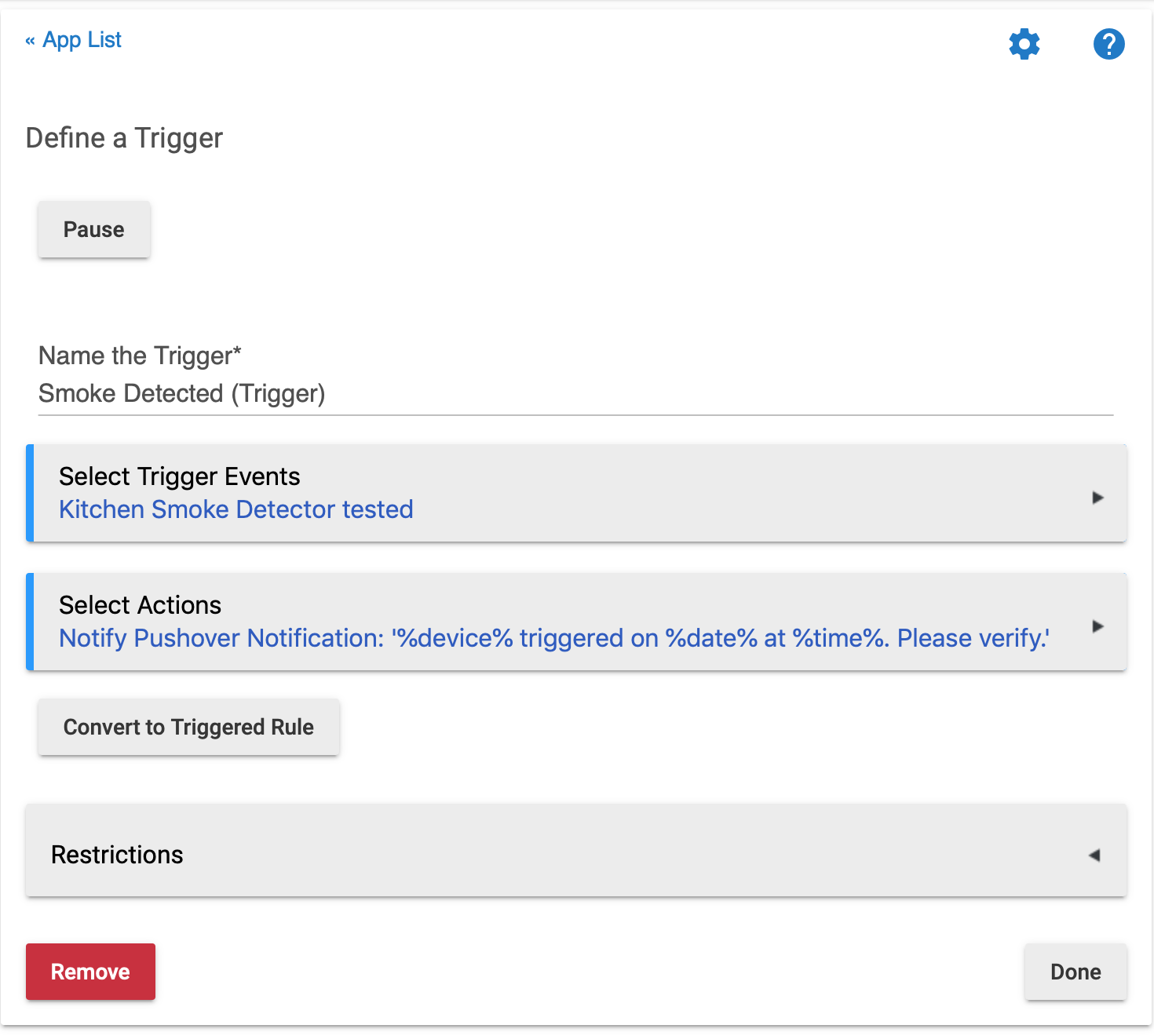

Without knowing how that specific device works, I suspect the issue is that you are mixing a trigger with a rule. If "tested" is a momentary event, it will never have a "state" of true, so the True actions will never run.
Change it to a Trigger instead of a Triggered Rule and try it again.

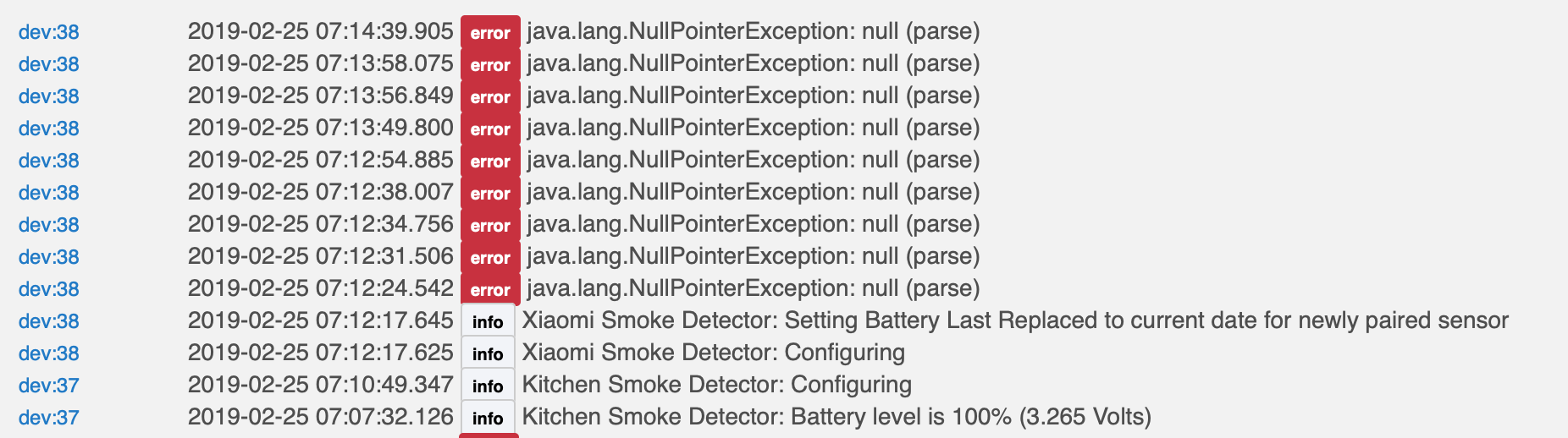

Based on your advice, I had created a trigger. It seems that it's a device issue from below log:
Re-added the smoke detector and pressed physical button on detector to trigger testing
After resolving driver issue and changing to trigger, it's working as expected now. :slight_smile:
Makes sense.
Step 1 when RM rules/triggers aren't working as expected is make 100% sure the device states/events are showing what you expect.
Since RM is event driven, if the device doesn't show the event, the RM side will never work.
