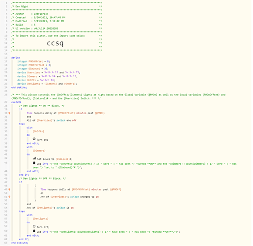

I use webCoRE and I have a number of 'pistons' that can temporarily suspend the piston's automation by turning on a virtual switch that I call an override switch.
In this example, the Den Night piston can be suspended by one of two override switches:
The override switch(es) can be activated or deactivated via dashboards, within the Hubitat app, or Alexa.

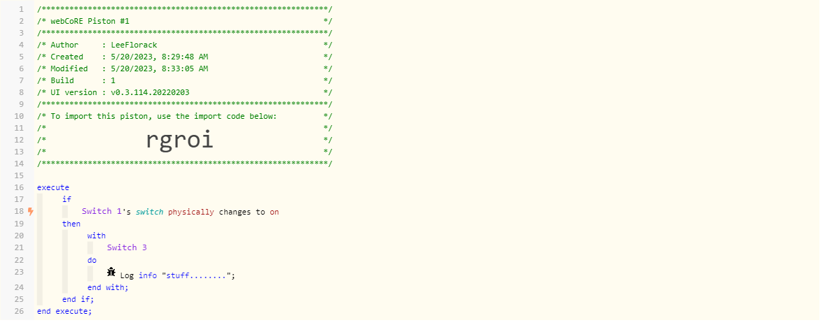

If your particular switch can indicate a physical action, you can still use this kind of logic to activate your override switch(es). In webCoRE, the use of the 'switch physically changes to" IF statement, would look something like this:
