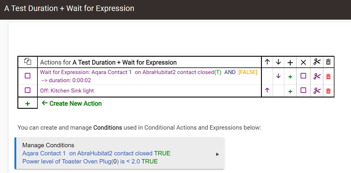

I need a way to wait for an expression or event that includes:
Set of contacts all closed
Power level for one power meter = 0 for at least x seconds
Needs to be an "and" wait, both conditions above have to be true, and the power meter condition needs an "and stays" setting.
Using Wait for Expression I can get an "and" to require both conditions, but expressions don't include the option to set an "and stays" option.
"Wait for Event" with two events allows me to set the "and stays" setting, but it defaults to "or" and I can't find a way to change that to an "and."
I must be missing something...
EDIT: Just realized it may look like I was trying to use both lines below in one rule - I was just showing examples of both the wait for event and wait for expression options. Sorry if that was confusing.
I. Start new rule
2. Single contact open as the trigger
3. Add one action - Wait for Expression using contact (same as trigger) to close, and then add second (using "And") expression to the Wait using power meter, and set a duration just for the power meter expression.
I have no clue how I could do the same thing twice in a row and have the same result, but then have the results diverge when I open the rule in another browser. Other than the cosmic particle. That works.
