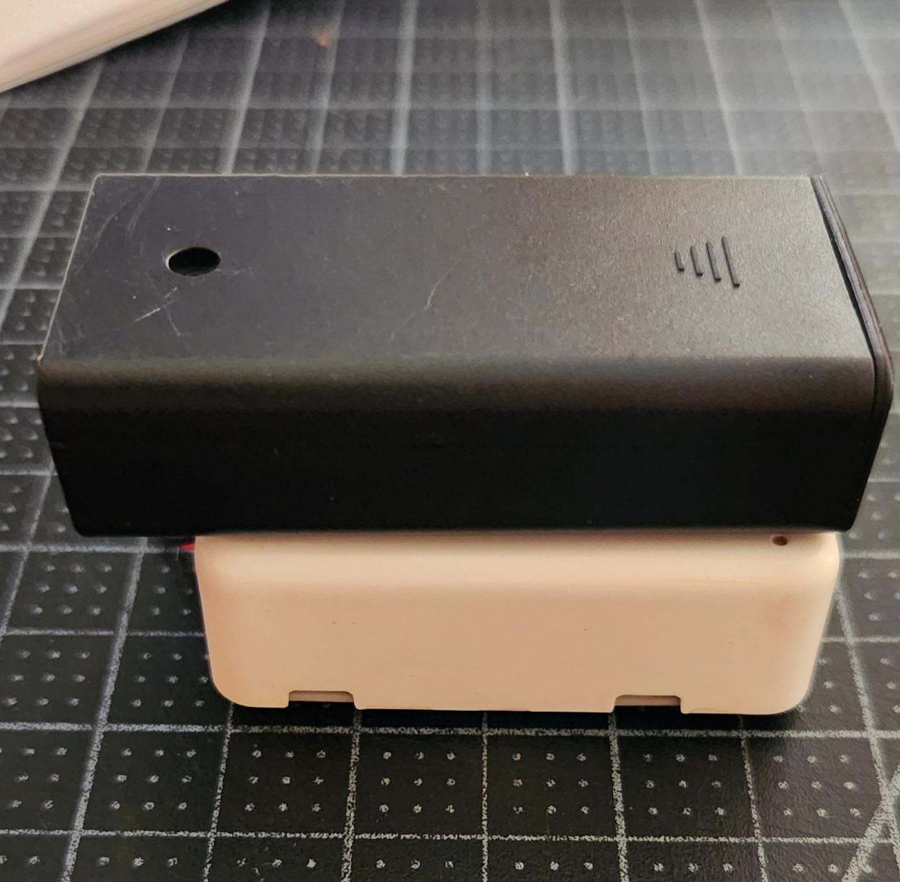

I converted all 9 of my old Iris moisture sensors from CR2 batteries to AAs. CR2s lasted about 8 months. I hot-glued the sensor to a simple AA battery case and soldered the wires to the battery terminals. Easy peasy. I switched drivers so they would not report the temperature. Wishing I could extend the battery reporting from 1 day to 2 days. Or have them report only when the batteries are low. Hoping to go 2+ years without a battery change.
Battery case with leads and on/off switch at Amazon Amazon.com: VWEICYY 6PCS 2 x 1.5V AA Battery Holder Enclosures with Wire Leads and On/Off Switch (6) : Electronics
