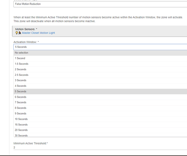

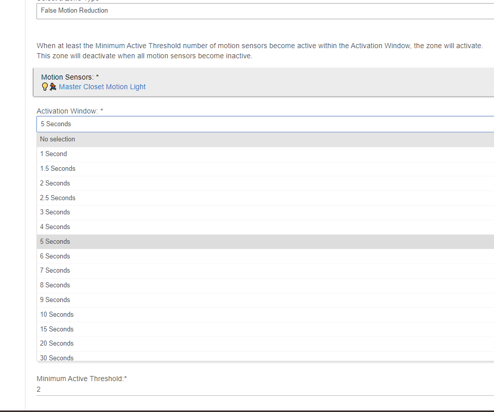

I think you're looking for false motion reduction which is built into the motion zone controller. Then add that zone to whatever rule you want to control.
False Motion Reduction When at least the Minimum Active Threshold number of motion sensors become active within the Activation Window, the zone will activate. This zone will deactivate when all motion sensors become inactive.

You can use a single motion sensor with it. No need for additional investment.
I didn't know this would work with a single motion.
With a single motion set up as a zone with an activation window of 5 seconds, is this saying - if motion A activates and is active for at least 5 seconds then activate the zone?
EDIT: Where does the minimum activation window fit in?
This might be exactly what I needed!
It is what you need. May need to play with the settings a bit to get it dialed in. Remember the device settings will play into this as well.
