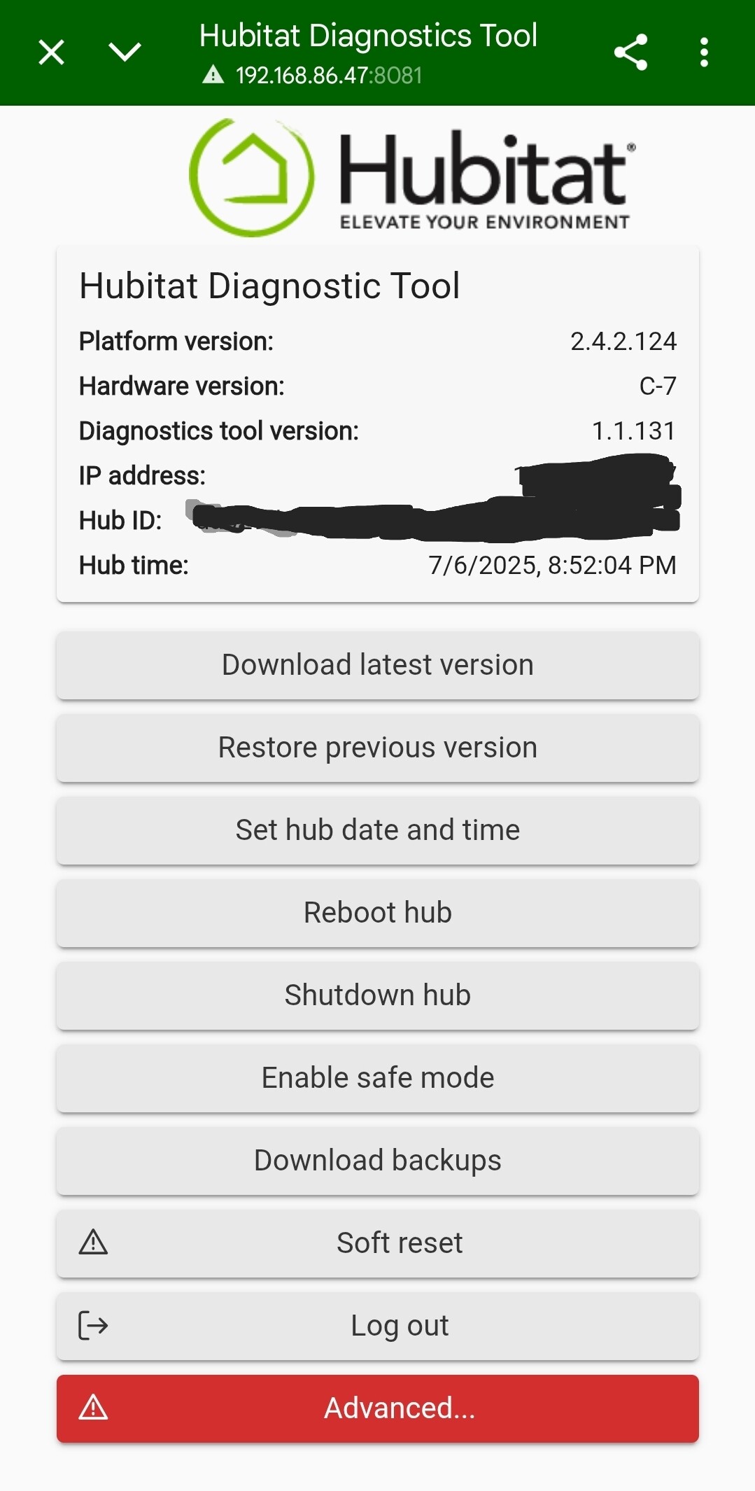

Did you do what @jtp10181 said about using the diagnostic tool. It has a option to download the latest release. On that menu. To get into it perform the following steps.
Go to the setting menu and open up the hub details page. Highlight your hubs MAC address copy it to your devices clipboard.
Go back to the Settings menu and scroll down until you have a button listed for "Diagnostics Tool" and click on it. This will take you to a new URL that is your hubs ip on port 8081. It will prompt you to enter your Hubs MAC Adress to authenticate. Paste in the address we copied earlier and you should get a new menu. It should look like what is below.
Please provide the Platform version, Hardware version, and Diagnostic Version. Also confirm the date and time are fairly close to real time for your location.
This is where you can download the latest platform version if you are behind, or load a previous one. I would suggest picking the option to download the latest version.

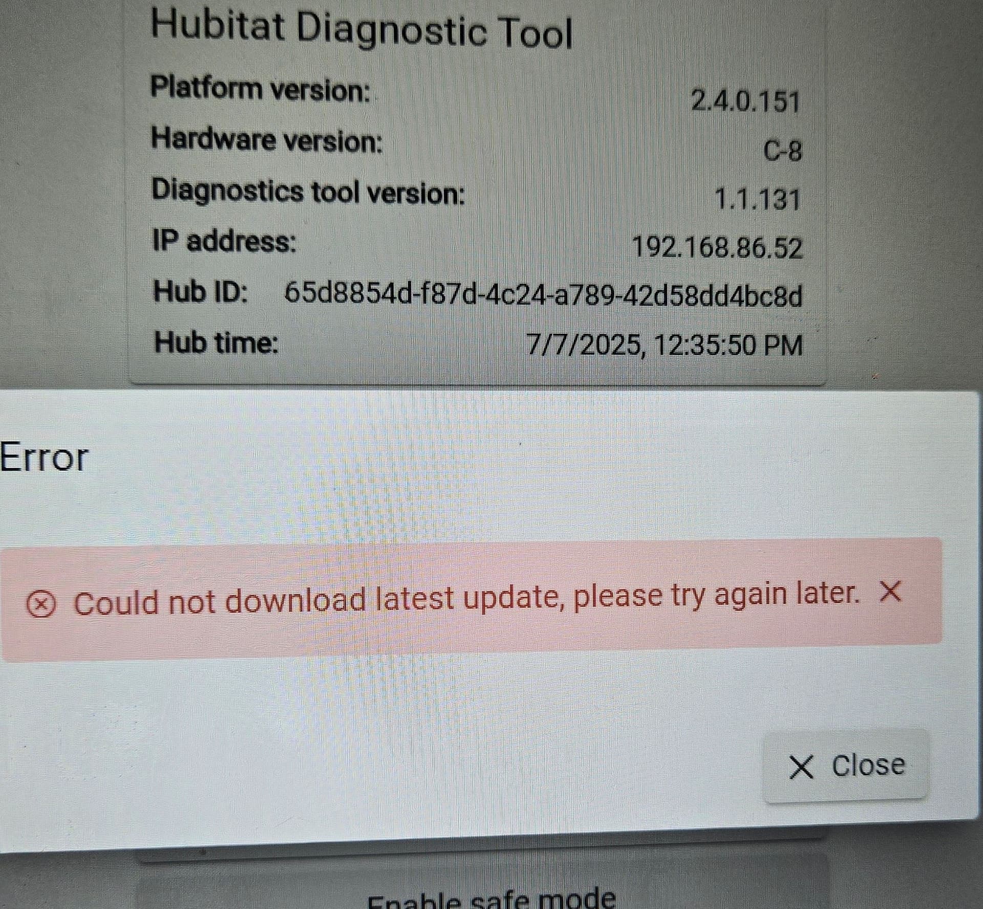

Yes, I have tried this before but I repeated it now. The Platform version is 2.3.9.201, hardware version C8 and Diagnostic version is 1.1.131. Time and date are correct, time out by 2 mins.
Tried downloading latest version and got this error 'Could not download this update, try again later'.

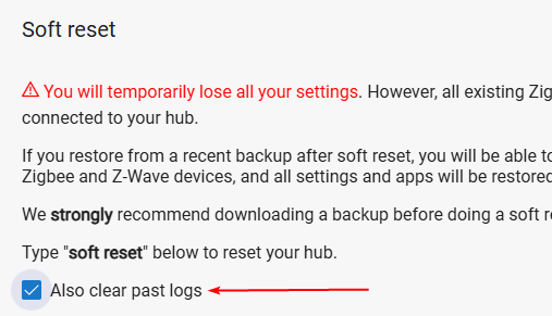

Do the soft reset with the clear logs option. Do not restore your backup until you get the platform updated. Let me see if I can find the other instructions.

Ok, so I followed jtp10181 instructions, including clearing the past logs and the zwave debug and disable command.
I was able to restore a newer platform, moved from 2.3.9.201 to 2.4.0.151, but after trying to update to the latest version which is 2.4.2.125, download failed once again.

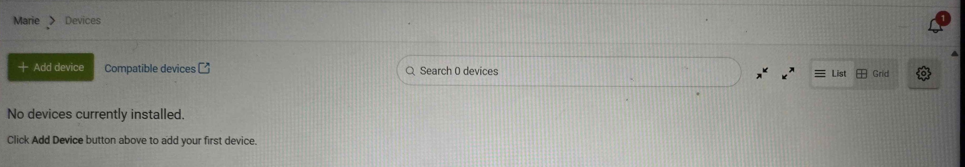

However, I am now seeing that there are no devices installed. I believe this happened after I soft reset but did not restore. I hope this does not mean all devices and automations are now obliterated

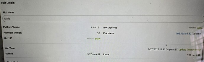

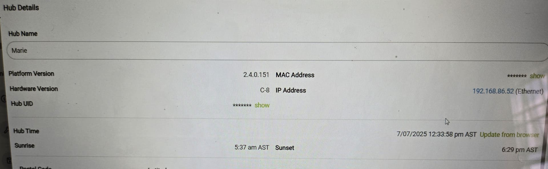

Can you please provide a screenshot showing you are on hub platform 2.3.9.151.
The soft reset resets the DB but not the radios. Once you restore the DB your automations and such should be back and functioning.

Mavrrick58, I apologise if I am using the incorrect terminology, so let me explain a bit more with pics.

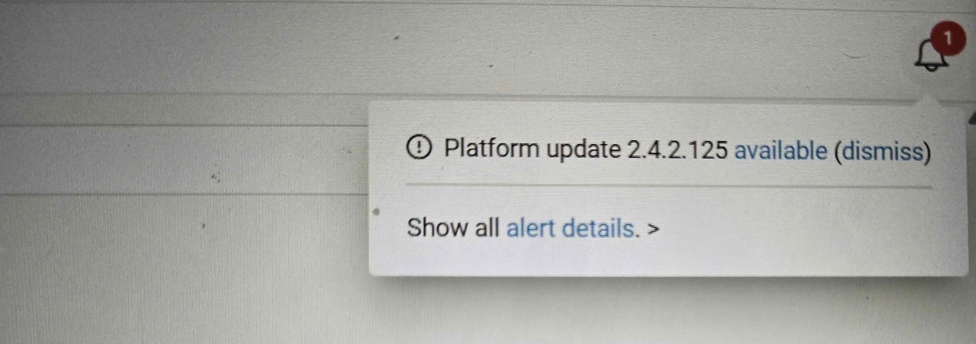

So as we spoke last night the hub was running 2.4.0.151 and that was the case today when I viewed the hub UI.
Unfortunately even though only a soft reset was done, no devices were apparent.

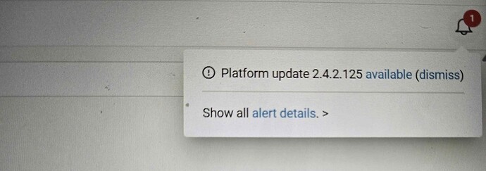

I tried to update the platform to the latest version again with no success.
Even though an update is available.

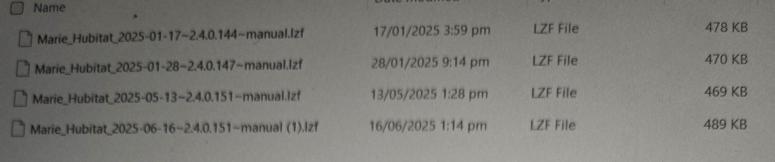

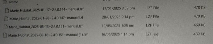

The statement I made last about 'previous version stored on the computer' was meant to refer to the back ups which are stored before updating..
So where I left it today, the status light on the hub is green but still the hub is unable to update to the latest version. Also at this point, even if the hub is salvageable, I will have to rebuild from scratch it seems.
But the main error continues to be inability to update the platform version.
I hope I did not leave anything out and that my pics went through..frustration is setting in..sorry.

No, the soft reset only wipes the hub database, not the device radios. If you restore one of your saved backups it will load the device list back to how it was. Just do not factory reset or mess with any of the devices.
The backups on your computer DO NOT change the hub platform version. 99% of the time you can load any backup on any hub platform without any issues. The version listed on the backup files is just a reference point for your info only.
Try running this endpoint from a web browser, it will seem to stall for a minute but let it run.
http://HUB.IP/hub/advanced/downloadPlatform/241
*Fill in with the IP of your hub
That should download the newest 2.4.1 build to the hub if it works. Then you can install it from the Diagnostic tool (restore previous button).
If that endpoint fails, along with the normal update UI and the diagnostic tool button, then I would say 99% certain it is some sort of networking issue on your end.
