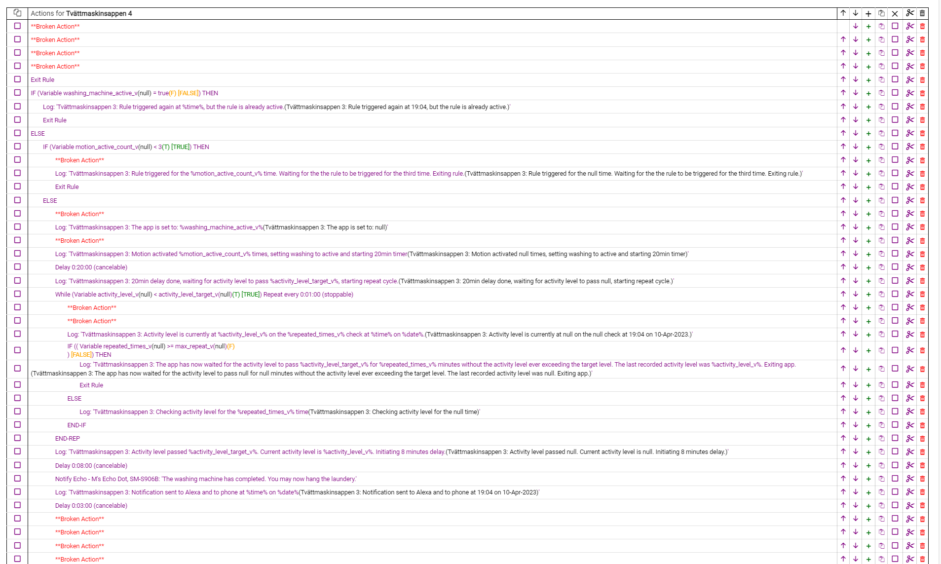

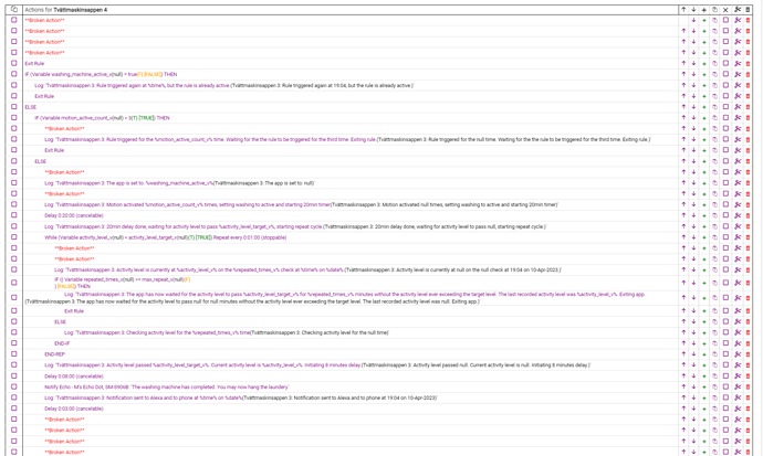

I copied a rule I am working on and pasted the rule code into a new rule. But when the rule code was pasted in, several lines turned up as Broken Action.

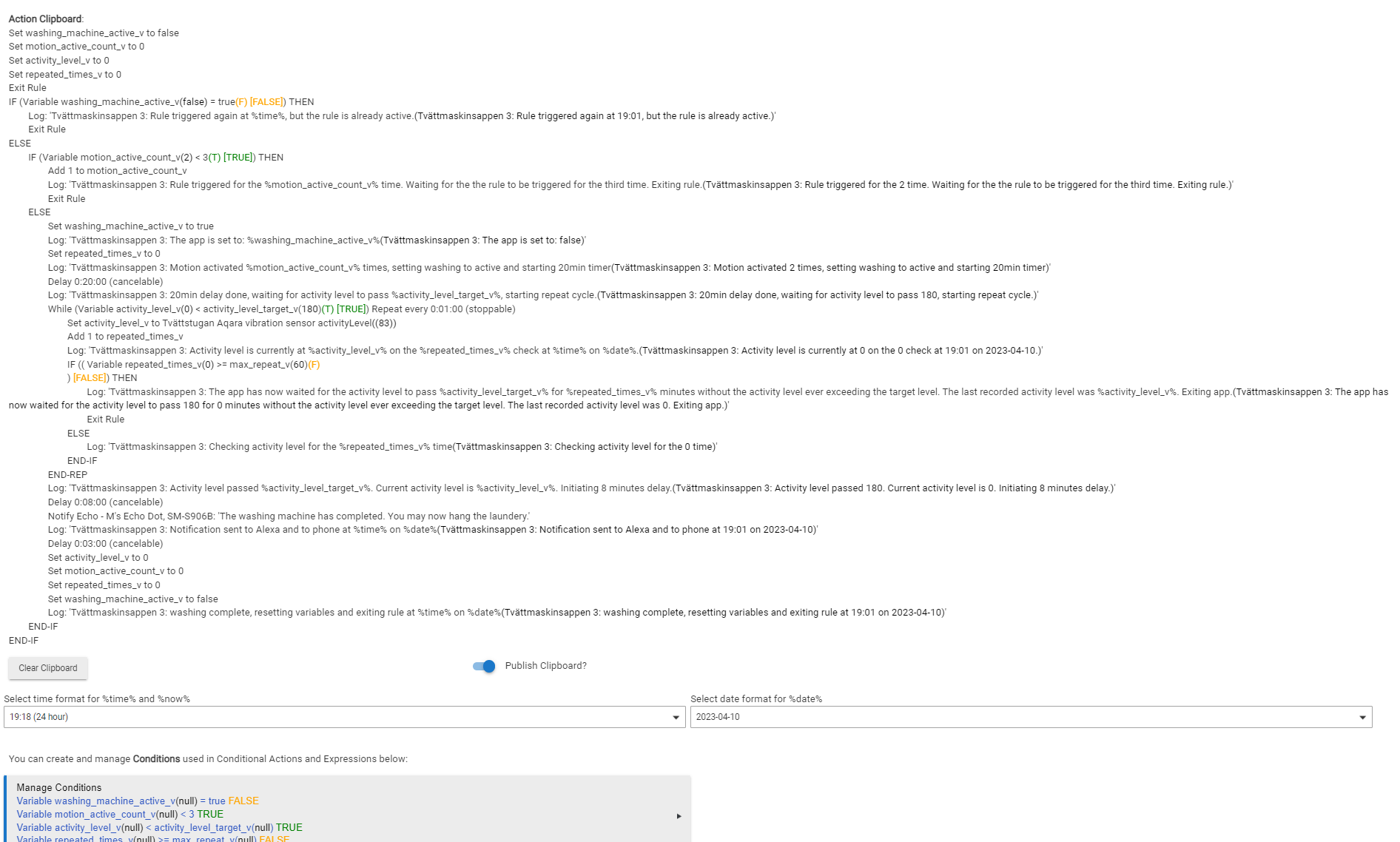

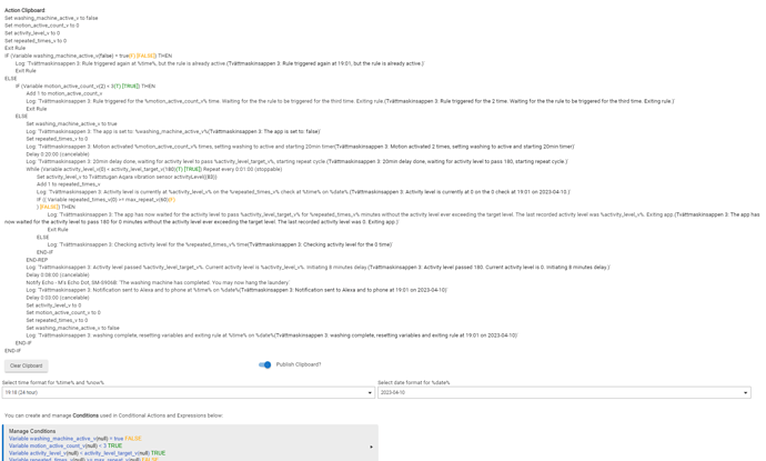

The clip board looks fine:
When this clip board was imported it turned up as:

Are those lines referring to local variables (as opposed to hub variables--most/all of the affected actions seem to involve variables of some kind)? I could see that happening if they don't exist in the "target" rule.
Ah, thanks @bertabcd1234 . Maybee if I define those first they will show up?
You would definitely need to define them in the new rule if they are local.
Thanks, yes, I see that. This was my first go at copying a rule in Rule machine 5.1 and I was expecting the clip board to be pasted as is with no validations.
If you want to copy all the lines to a new rule, you could also use the "Clone" option. That will copy the local variables as well.
