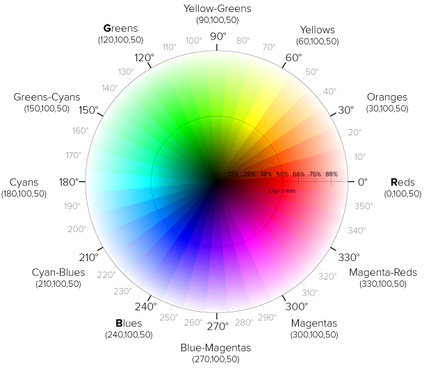

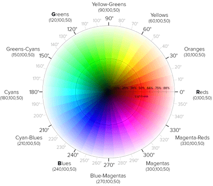

Color is a function of Hue, Saturation, and Lightness, as exemplified in the HSL color wheel that I've inserted below. As indicated by @djgutheinz, you can use setHue() and setSaturation() commands in Rule Machine or your own app, to mirror the Hue and Saturation from one Yeelight bulb to another.
However, be aware that Hue and Saturation are insufficient descriptors of color. The color achieved with HSL values of (100,100,100) will be different than (100,100,10).
