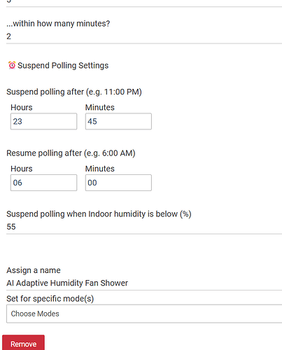

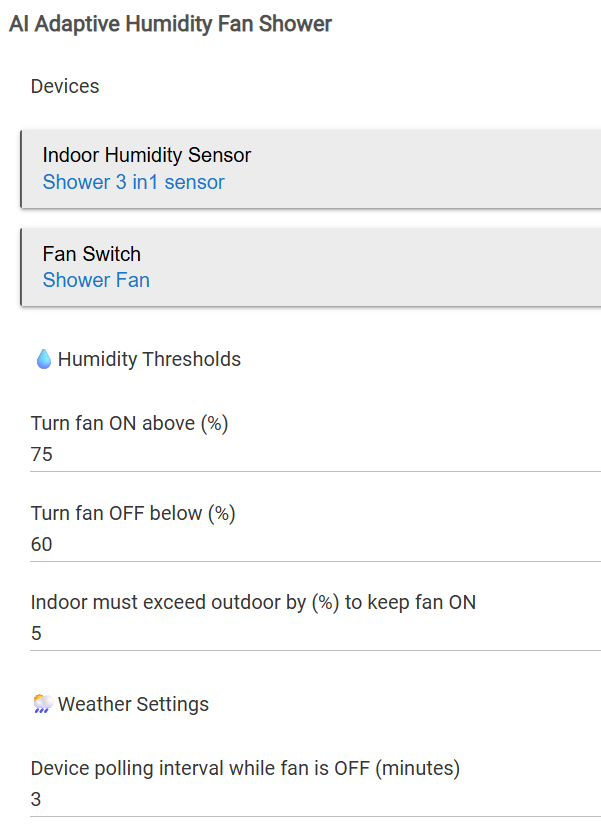

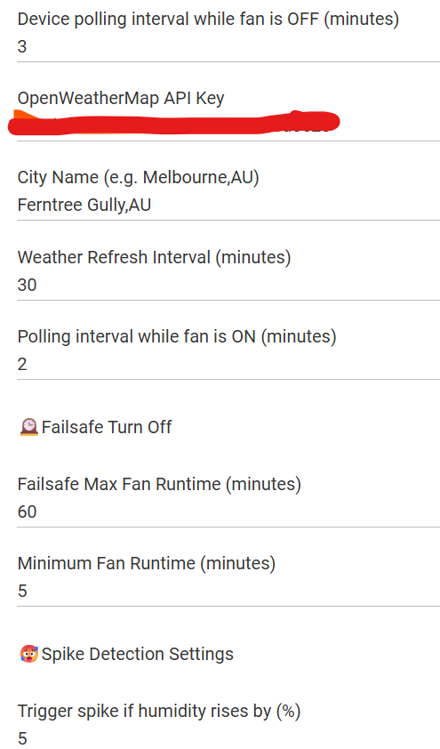

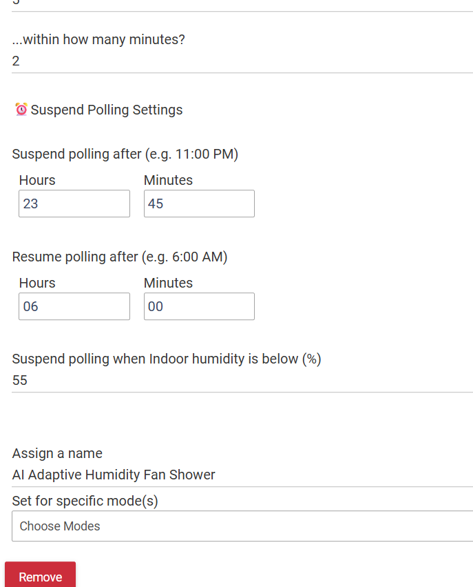

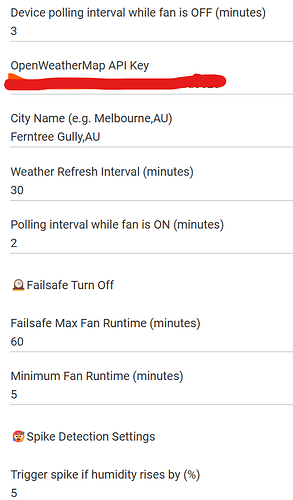

I have gone from creating a few rules in Rule Machine to directing Co-Pilot (split screen) to create a totally over-spec'd app which controls my fan against device humidity, openweather humidity, time of day. Customised triggers and polling, auto off, conditions for on. It probably has some logic errors and useless processes, but that's not the point. This has all been achieved with absolutely no programming knowledge. Yes, I cursed Co-Pilot numerous times and almost gave up a couple of times. But explain what you want and co-pilot will follow your instructions and build it. And I've learned a lot quickly.
