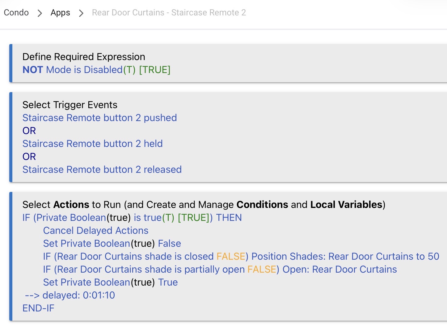

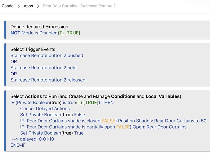

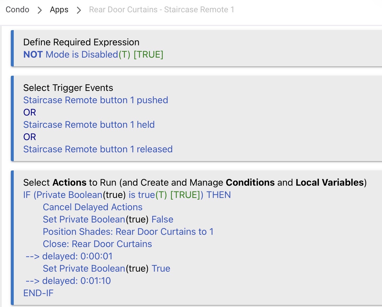

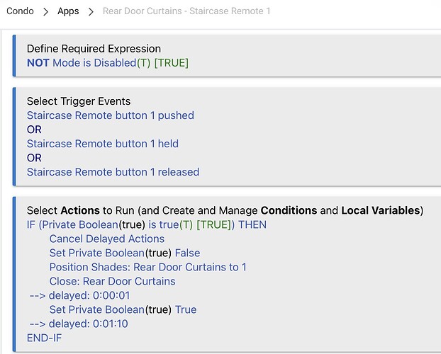

I just use RM, the private boolean is just in case i hit the button too fast. The open is a little extra cause by default i only need to open it half way.
Typically i dont use this automation and is basicly a manual override, my shades typically open/close based on sunrise or my wake up routine and sunset.

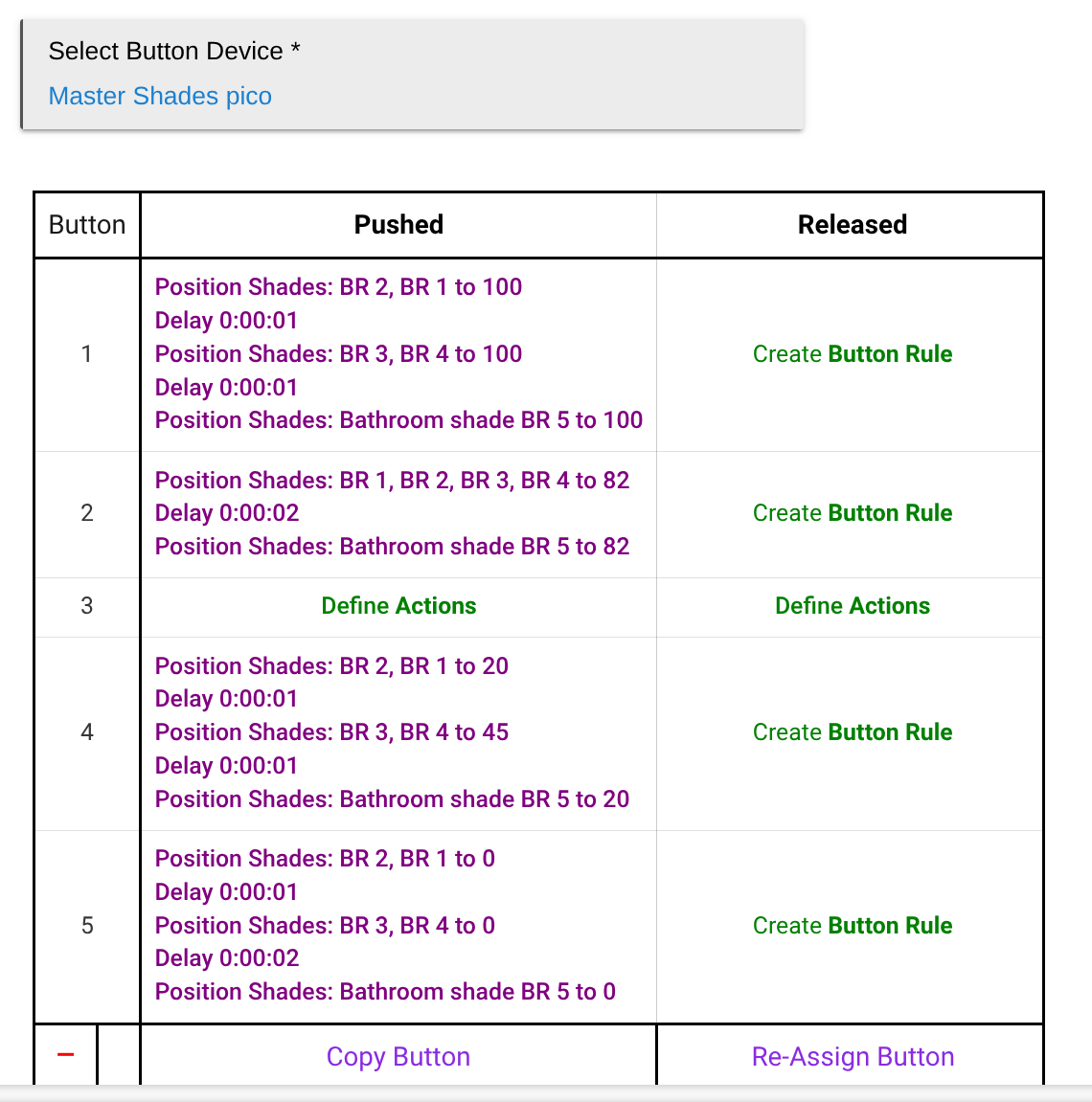

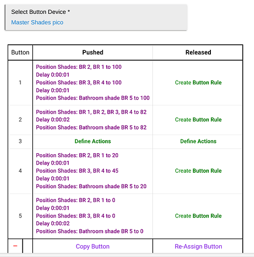

I do this with Lutron Picos and the Button Controller app. My guess is you can do similar with the Zen35. For our purposes I use the five buttons to set open, closed and three predetermined intermediate positions. That fits our needs perfectly. Example for our bedroom shades. In this case I use button three for a separate rule to toggle the master bathroom shade open and closed. In other rooms three is a middle level setting.
