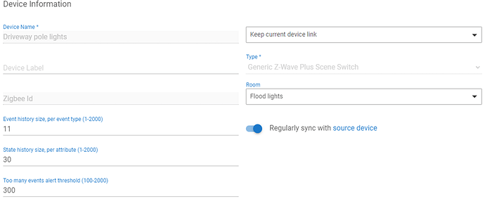

On the 2nd hub, under Hub Mesh->Local devices my light switch shows up under Shared devices.
pic1

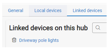

On the 1st hub, under Hub Mesh->Linked devices the light switch also shows up.
pic2

No sir, it does not. It shows up in the device list with source "Linked", and says last activity was this morning.
pic3
But, when I click "On" on the devices device page (shown below) nothing happens. Also, several of the boxes have a thin red line under them as you see below.
Here is more device information from the switches device page:
