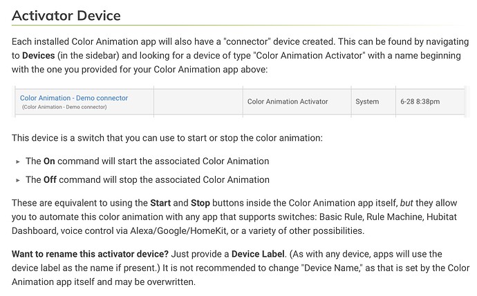

What you want to do is very straightforward. See the following Activator Device section in the documentation for the Color Animation built-in app:
Just create two simple rules in Rule Machine to turn on and off the Color Animation app you created:
Rule 1:
Trigger on Sunset (Location Event, Sunset)
Action:
Turn on the activator device switch that is created when you built your color animation child app.
Rule 2:
Trigger on time midnight (Time of Day, certain time)
Action:
Turn off the activator device switch that was created when you built your color animation child app.

Cool - that works great. I guess I need to RTFM* sometimes.
