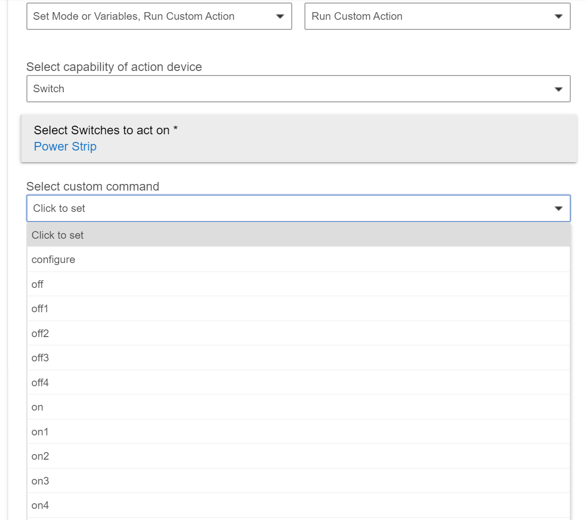

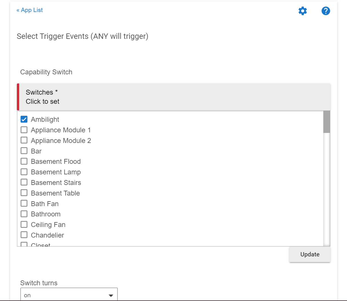

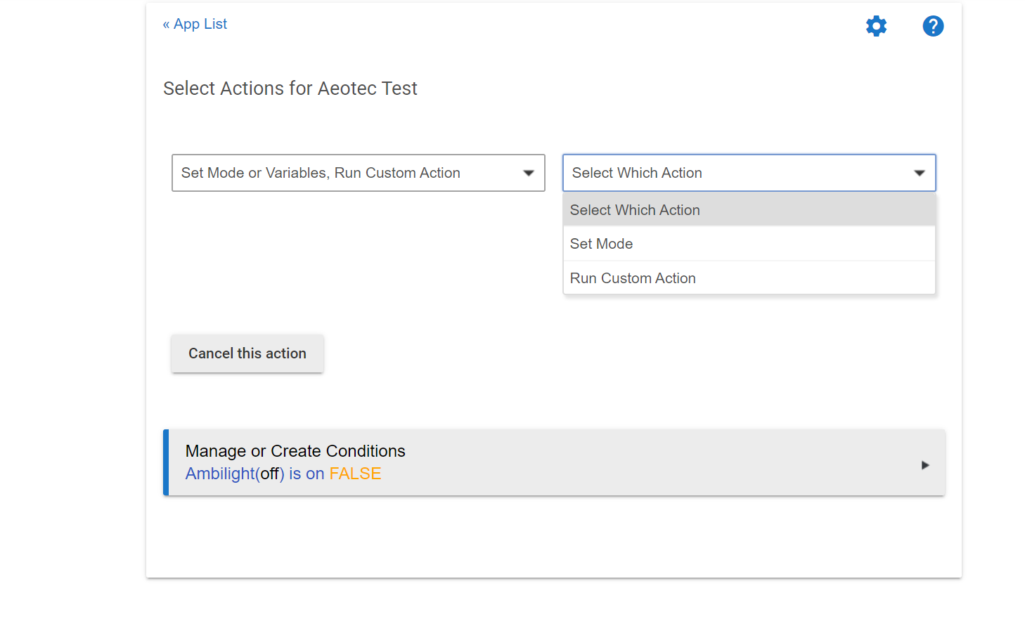

@lou I got mine to work after a very frustrating few days. I will get some screen shots for you. To start when you are in RM you need to set it up with the custom action of the Aeotec power strip. I myself am very new to Hubitat from Vera as you are so I have to take a few and put together screen shot and explain how I did this.
OK here are a few screen shots hope it helps.
Step one
Step 2
Step 3
Step 4
Let me know if this do infact help or I need to get you more!

@sky320 Thank you so much. I will try the procedure and report back.
@lou Make sure to create the virtual switch also!
@sky320 Worked like a charm!! Thank you so much for your help!!
