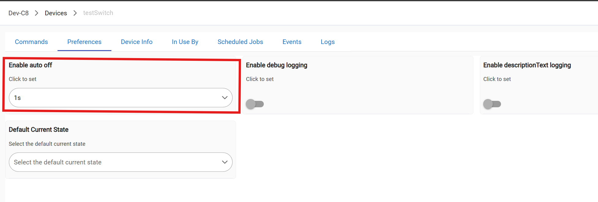

The built-in Virtual Switch driver includes a user preference to automatically turn off the switch. This makes sure the switch is ready to be used by Alexa again without having to worry about turning it back off.

When I was initially setting things up I tried a switch and it didn't work. It seems to be working now though. That makes things a little less complicated since the switch has an auto off. I have been creating that for the locks lol
