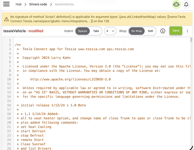

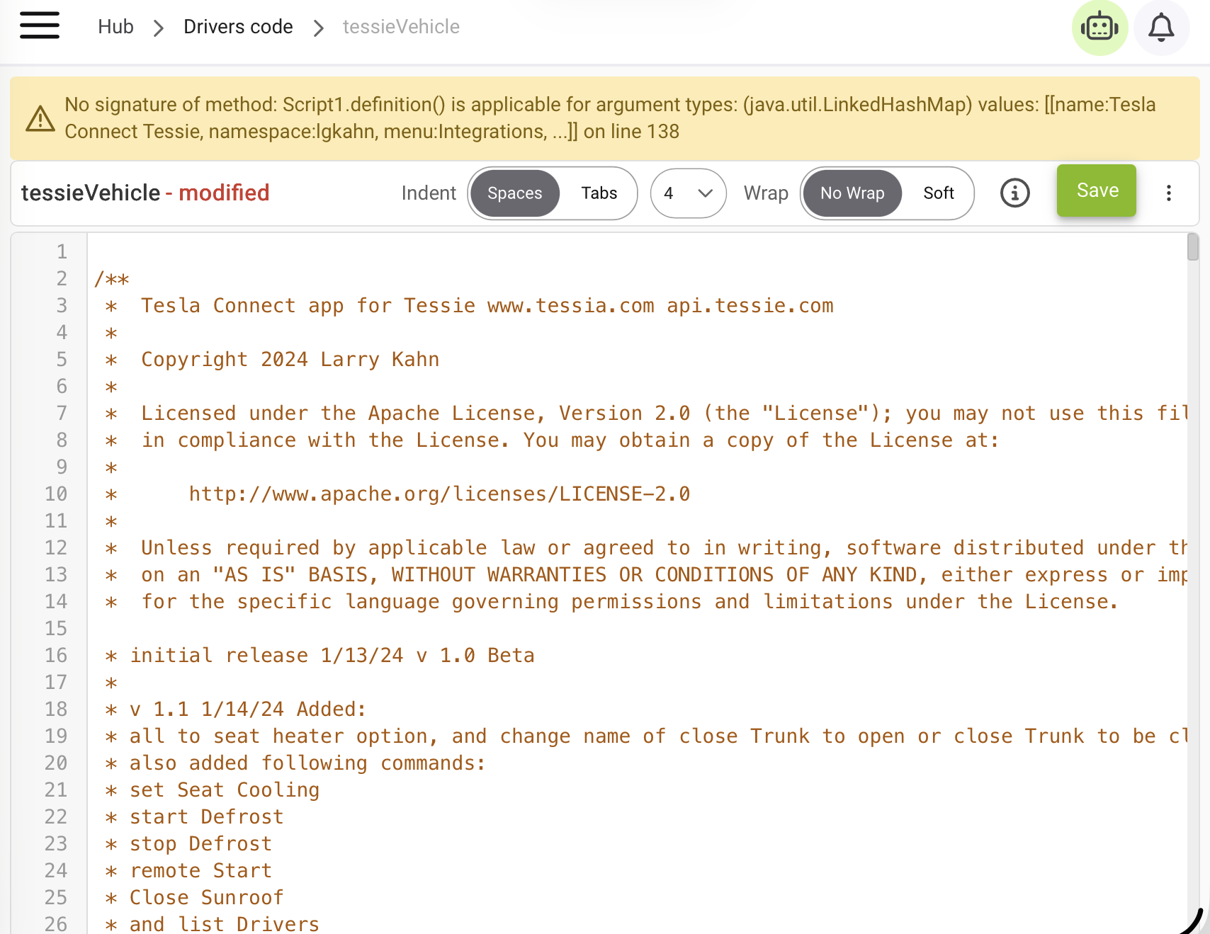

Also note that I tried updating the driver to the latest version via the following import link:
https://raw.githubusercontent.com/lgkahn/hubitat/refs/heads/master/teslaConnectTessie.groovy
However, I get the following error when attempting to save:
looks like your trying to save the Tesla connect app src over the tessie vehicle driver. why are y not using package manager
That’s a good question! I am, so yea, I should have instead done a manual update… did I mention it was late? :wink:
