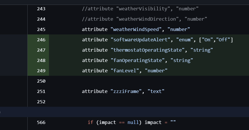

@kahn-hubitat on your next code turn can you add:
attribute "softwareUpdateAlert", "enum", ["On","Off"]
and at line ~1764 update 'SoftwareUpdateVersion" to:
"SoftwareUpdateVersion": { it -> sendEventX(name: "softwareUpdateAlert", value: (it.value?.stringValue?.trim() ? "On" : "Off")) },
I use it to enable/disable my iPhone hotspot via iOS shortcuts and homekit to when new software is available.

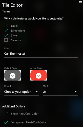

I'm currently using the thermostat tile and would like to be able to change it to colour red when it's on or auto.
image (2)
Is it possible to add the thermostatOperatingState attribute?
TIA

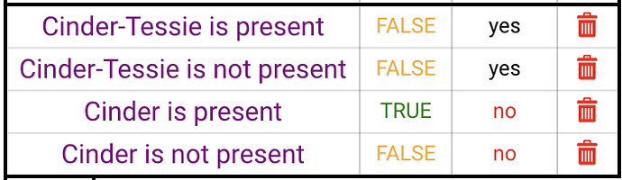

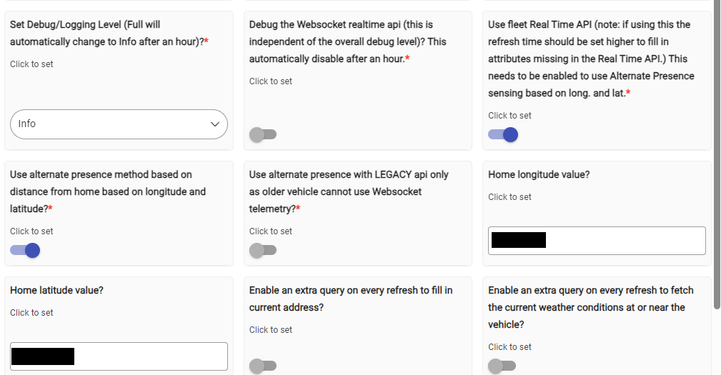

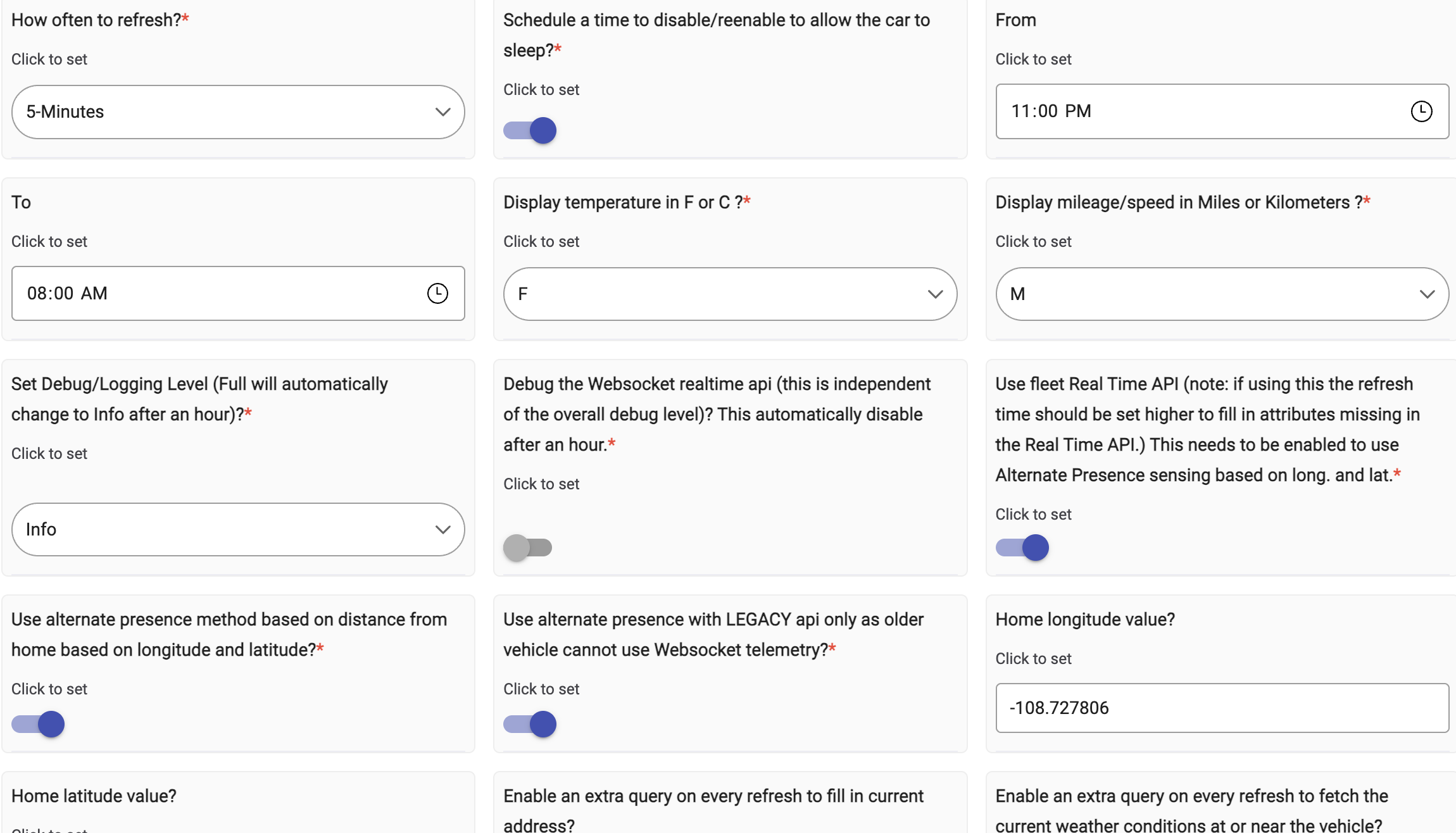

I'm trialing Tessie with my Cybertruck, but presence isn't working. I've enabled everything and set long/lat correctly. What might I be missing?
you cannot use both fleet api and alternate legacy api one or the other i assume you can just use fleet.. need to turn on debugging and post logs as you drive home.. also cadnnot see what your distance is set to.. also double check your long lat. are not reversed
Oh I clicked both on just a second before posting, legacy was off before. I double checked lat/long as I'd read previous posts! Will it only change status when driving into/out of the zone? I haven't moved since setting it up. I'll test that out tomorrow, thank you!
make sureis debugging on before driving to get the logs.
Here's the logs. My Teslamate connection shows present, but not the tessie one.

not sure what those logs are there is no pminfo pmwarn ect in my logs.. looks like you re running a modified version

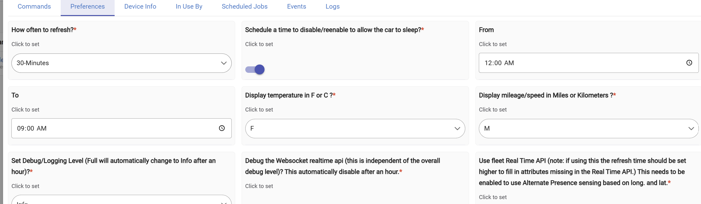

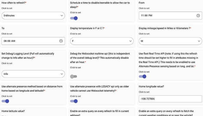

also need the settings posted all of them
]and with full debug it should look like those but that is not coming out .. so agaion not sure what that is

turn on debug websocket api as well. that location data is not coming back from the websocket thats the old normal refresh..
my guess is as mentioned previously the websocket telemetry is nt working from tessie..
there is already a thermostatmode attributer that hass off auto you should be able to use that.. i will add thermostat operating state so you can put a therm object on a dashboard
new version 2.42

Yes, if you don't have the HomeLink module, then you will want to enable the 'fleet Real Time API' and 'Alternate Presence Method" and set your home lat/lon.
Using the real-time API, the car's location will update about once per minute when it is motion.

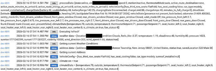

@kahn-hubitat, do you know why the outside temperature of the car is always showing 0? Currently, the temperature is around 30F.
