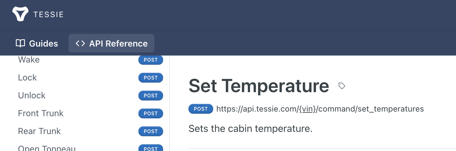

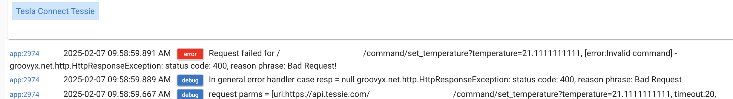

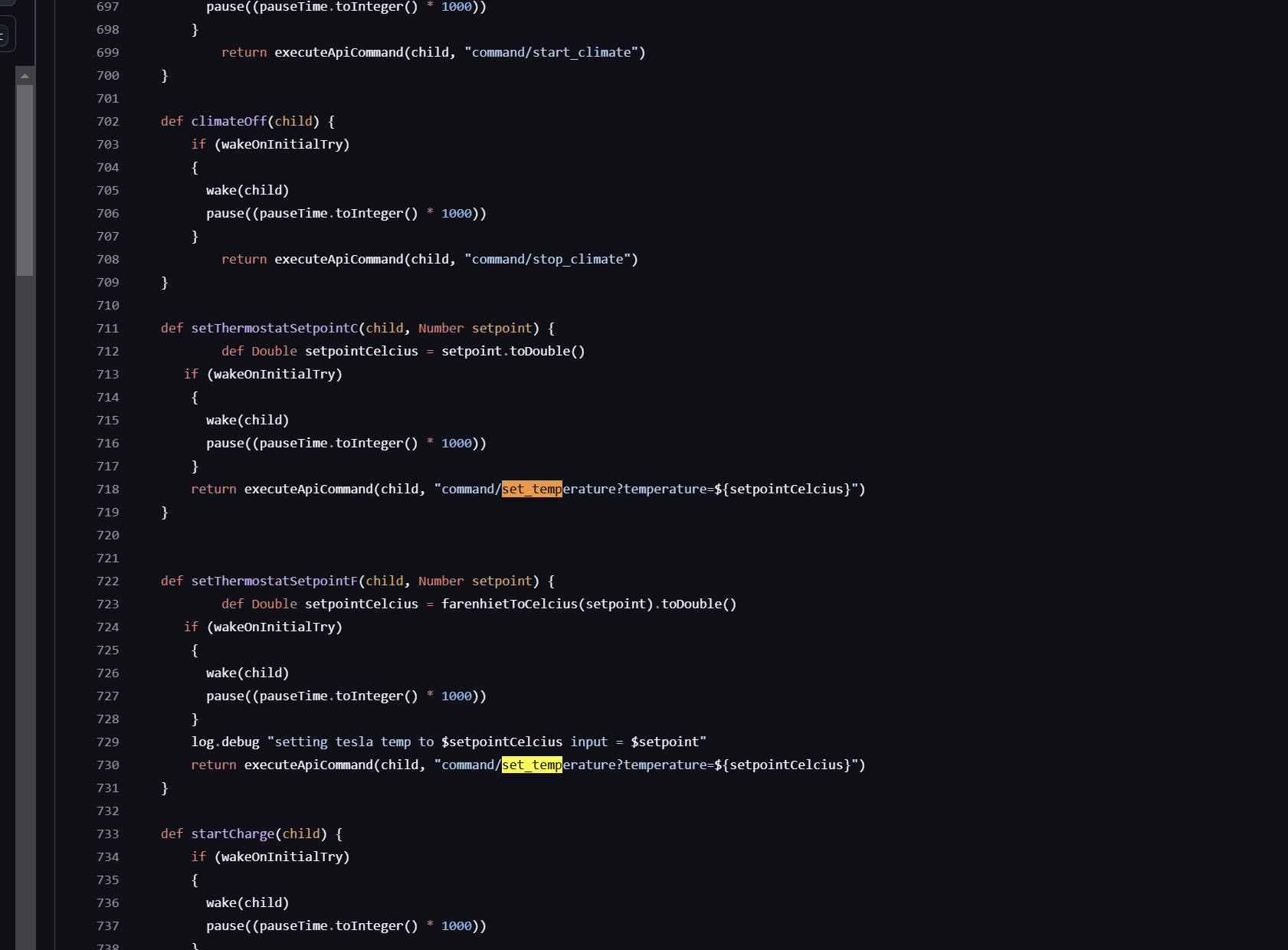

I was getting the following error when trying to set the temperature with the real time API turned on.

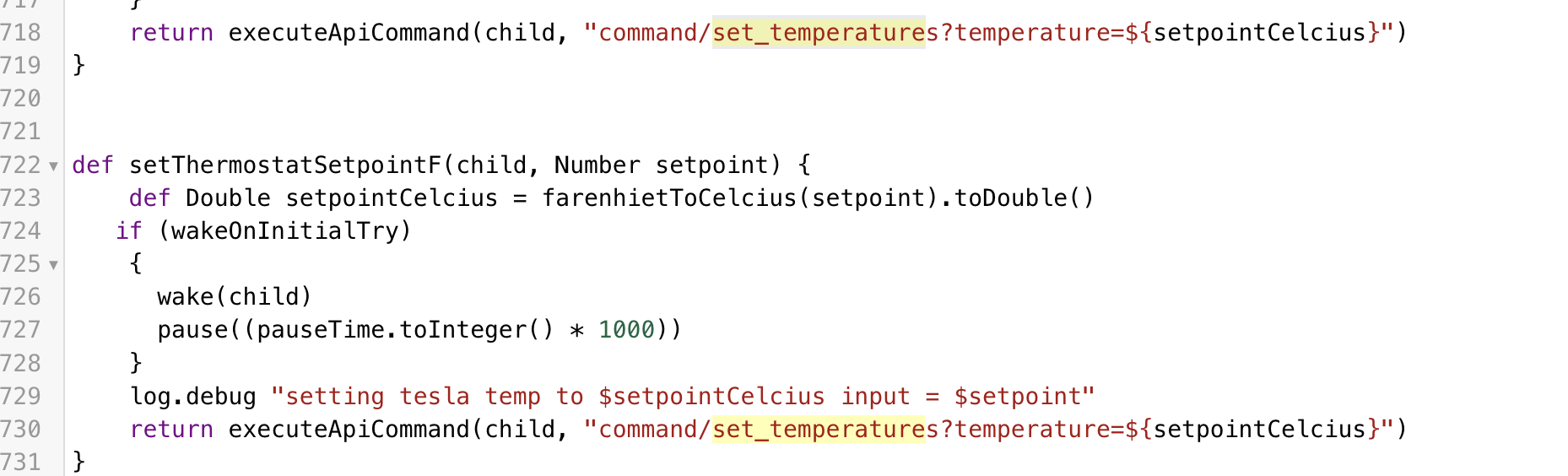

I fixed it by changing "set_temperature" -> "set_temperatures" in lines 718 and 730 of the app.
Using latest versions on HPM and github.
App version: 2.13

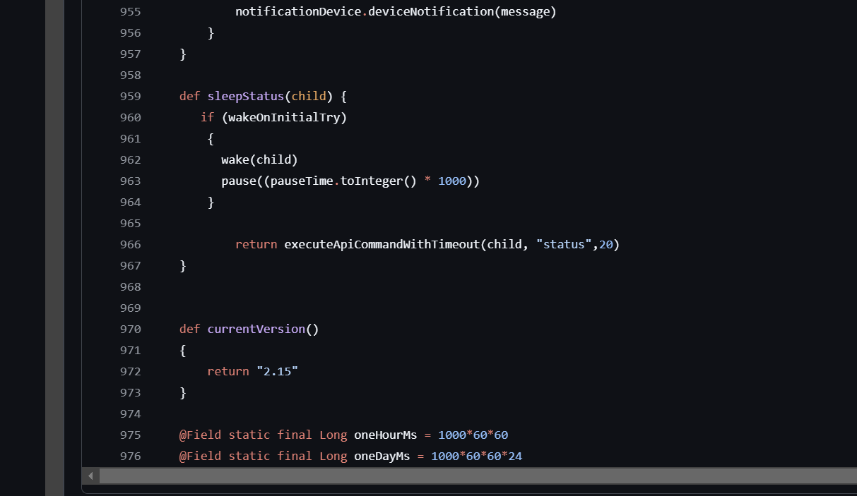

Thats not the latest. Was already fixed in 215 you are running old app version. Should use package manager.
I did. I even did a repair.

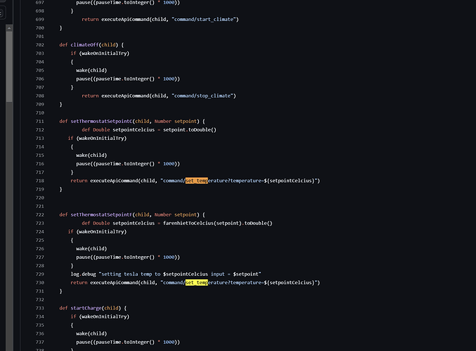

well if you check the git hub NEAR the lines you specified you will see it was already fixed and in addition at the end of the file you will see the version is .215
I did another repair. I was going by the changelog at the top where the last entry is 2.13. However, near the bottom, for version, it is actually 2.15. So I was using the latest 2.15 version. My bad.

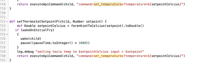

In your screenshot, the command is showing as set_temperature in lines 718 and 730. It still needs the "s" to make it set_temperatures to set the cabin temperature without error.
weird thats what i had originally and had to change it as it wasnt working with the s.. i wonder if the api keeps changing.
v 2.16 with this fix thanks.

I think it is constantly changing. I was reading a couple other commands earlier in the week and when I looked again today, the command had changed. I'm still rubbing my eyes and thinking I read it wrong earlier, but I know that it actually changed.
If u see changes post them so i can check the app.
