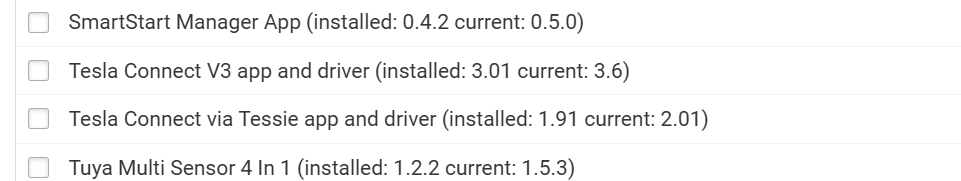

HPM still shows 1.99 as the latest. Will 2.0 be a new app entirely, or will the HPM update work once you publish it there?

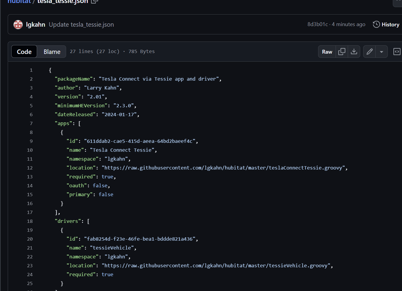

ver 2.01 is out for testing round the time to arrival to 2 decimal digits.. i did update the hpm so the problem is with them pulling the update
hpm is showing the update to me.. something with your setup..
ie
also i have not tested the round/truncate as i havent driven the vehicle so someone test it and let me know or i will this evening.
Yup, there was some weird caching issue. I see it now! Let's write some new rules! Thank you!
