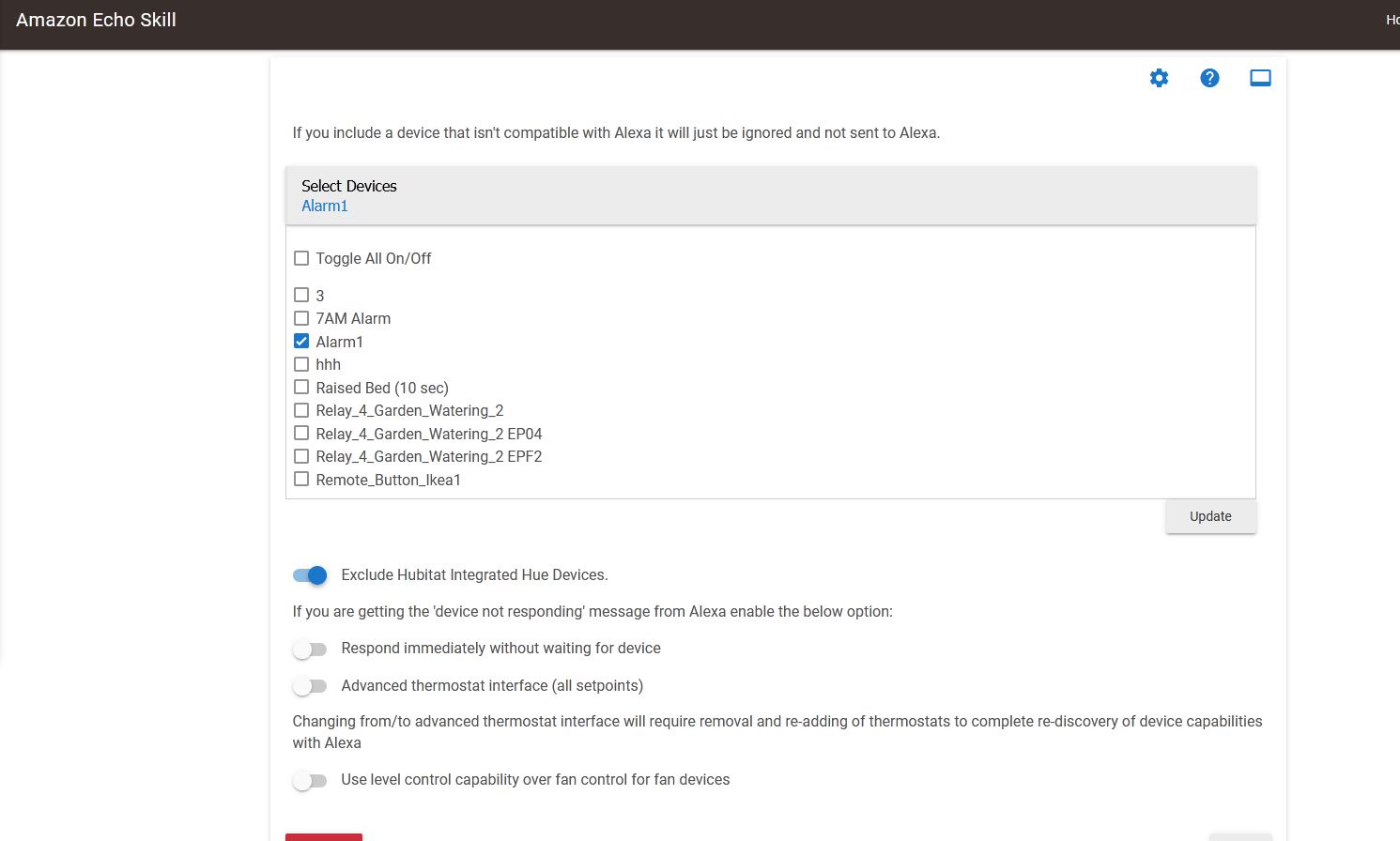

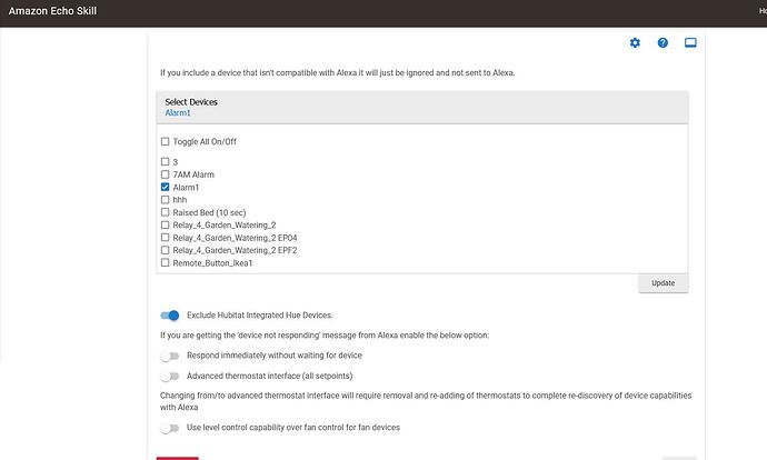

Is Alarm 1 the virtual switch you created?

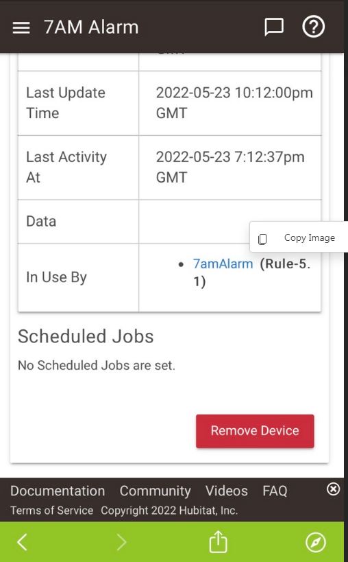

Alarm 1 and 7am alarm
Theyโ€™re a test switch
I have managed to get the to appear as an Alexa device.
Cannot see them to start a routine or do something.
