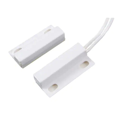

I would suggest something like https://www.amazon.com/Z-Wave-Magnets-Window-Sensor-DWZWAVE2-5-ECO/dp/B01N5HB4U5 with an external magnetic reed switch. the reed switch should be able to survive the weather while the actual sensor can be placed where the weather can't destroy it. the only thing would be to make sure the terminals are properly sealed (hot glue gun ftw)
I believe the Sensitive Strips are completely sealed and weatherproof.
Another option is a contact sensor with the ability to sense external contacts. Put the contacts on the door and the electronics up near / on the ceiling.
