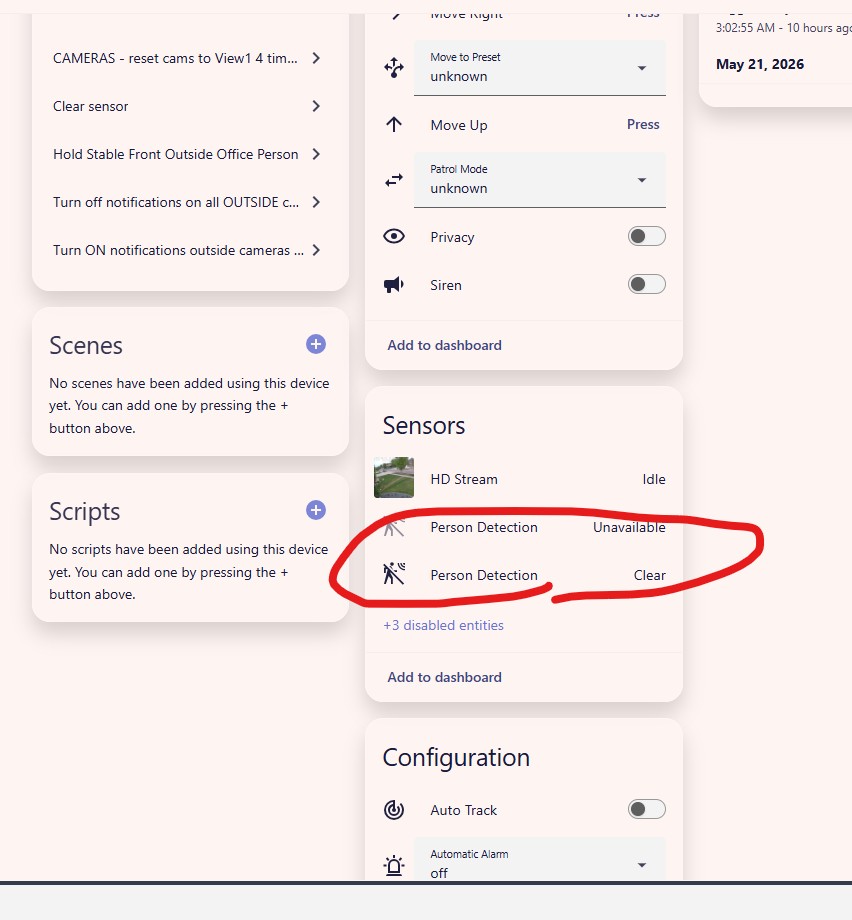

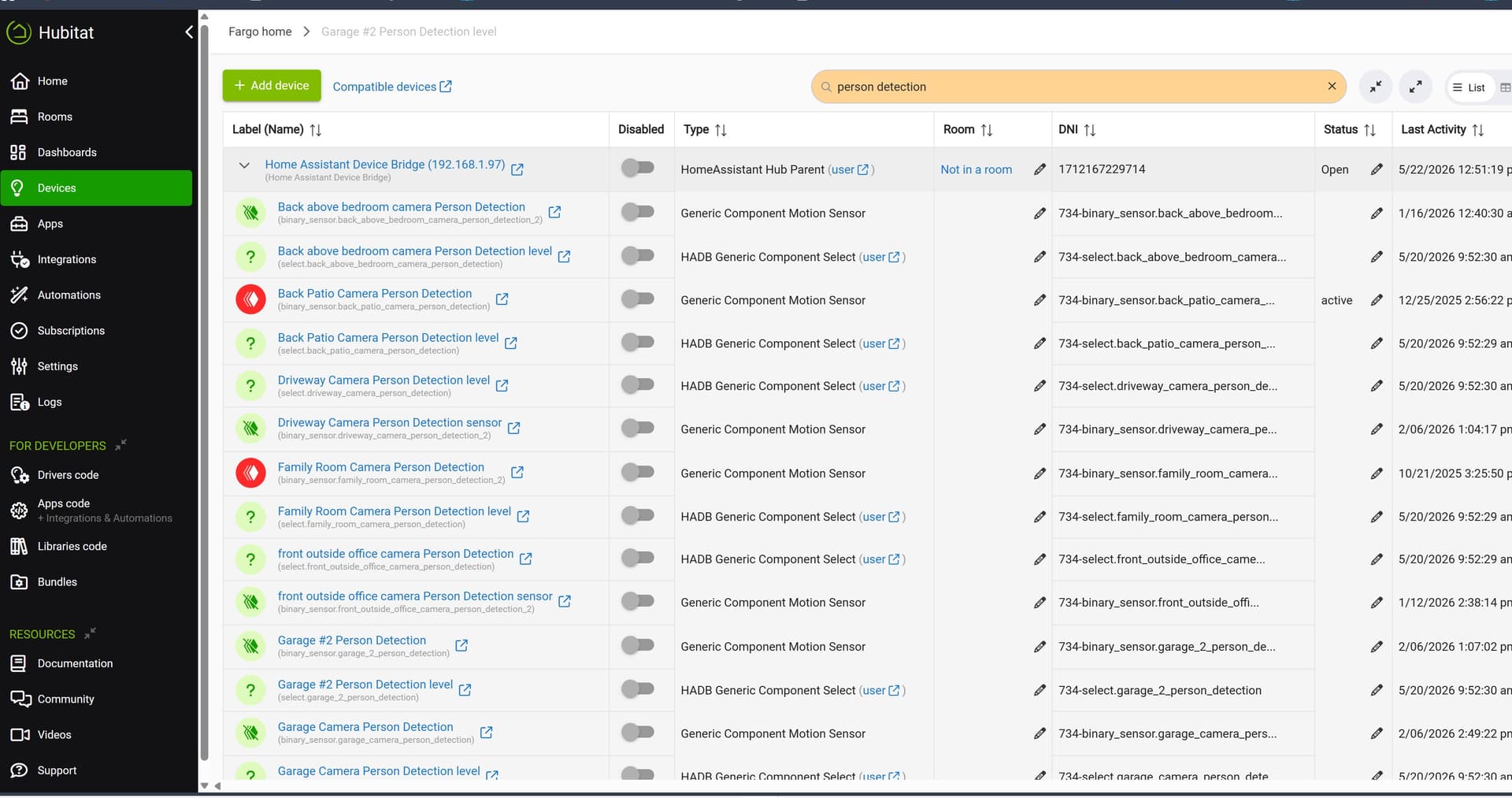

But motion triggers ARE available in the HA tapo integration - AND can be moved over to hubitat via HADB. I have been using them for well over a year now.
Remember, you won't see them in HE until something triggers them in HA or possibly with a reboot. It will be (in HA) similar to ....Binarysensor.front_outside_office_camera_person_detection

Go walk in front of one of the cameras in question and see if you person detection gets enabled. THEN and only then can you push it via HADB. and THEN you gotta wait on THAT too. Get that working and I can talk to you about stablizing it so you don't have to futz with it. Worth the effort - it was one reason I added HA to my automation setup - Hubitat is still the king, but I use HA for stuff like this AND for dashboarding vs. Hubitat FAR FAR superior.

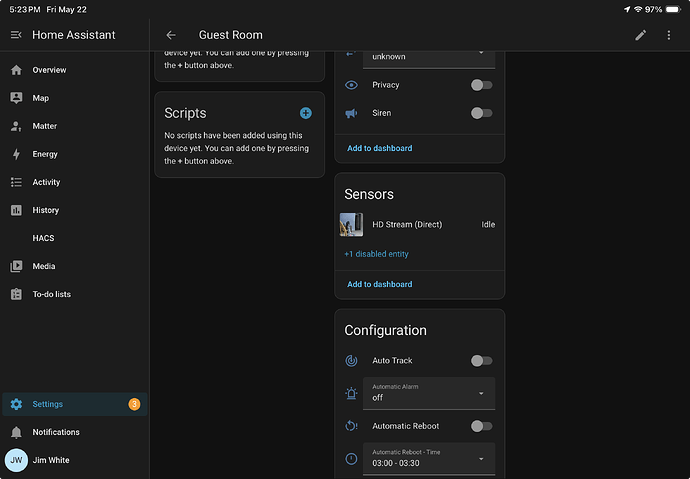

I used the integration you mentioned. Still nothing. I can verify the camera is getting triggered but not showing up in HA.
What's the entity at the top that says "unknown"? First thing that jumps out to me.
Patrol mode
I see now. Should have looked at @tjfontaine 's screenshot before asking. I don't own these cameras, so I'm not going to be of any use. To @ymerj 's point, you two might be using different integrations if your cameras are the same or similar supported models with the same firmware, or to @tjfontaine's point you might be connected directly to the camera with the integration rather than the cloud account. I noticed that his says "HD Stream", but yours says "HD Stream (Direct)". Not knowing this camera, that to me sounds like a local integration, rather than a cloud integration.
Obviously, if there's no entity on HA then it's impossible for you to get a device created with HADB. You wouldn't even be able to create an automation on HA for the camera's person detection notifications, if there's no Person Detection entity to start with.
