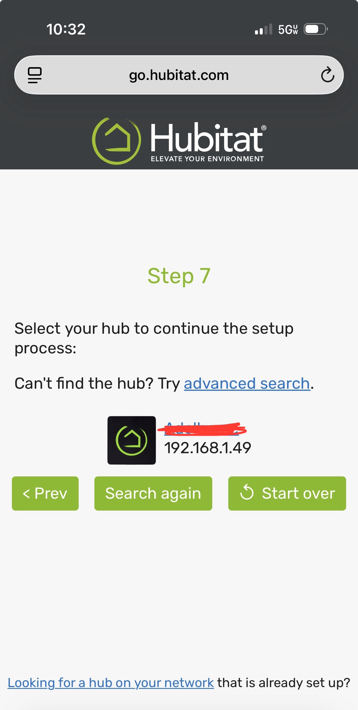

For example, Tailscale is running on my iPhone right now. There’s a windows PC in my home running Tailscale and configured as both a subnet router and exit node.

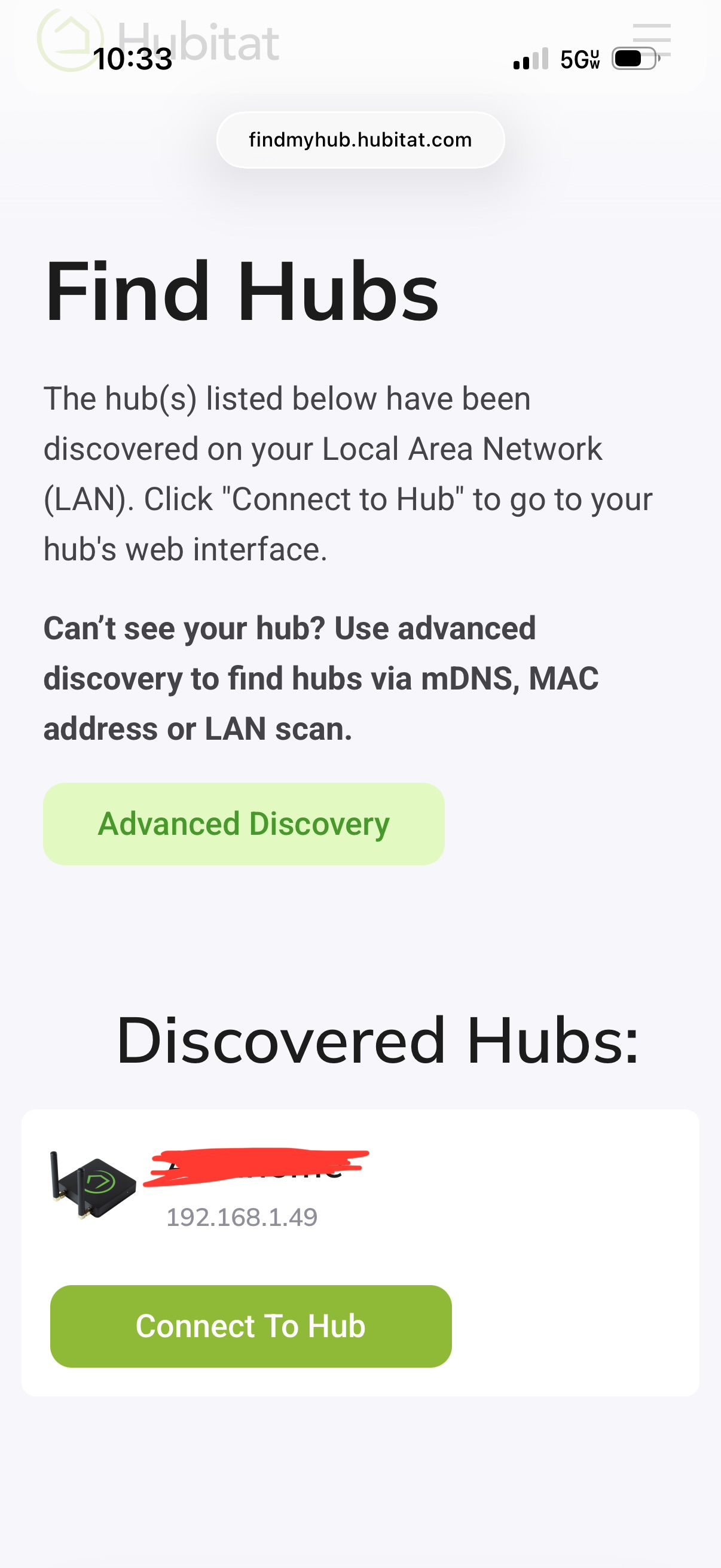

When I enter go.hubitat.com (I believe that’s the link for registration), here’s what I see:
It found my hub even though I’m not at home.

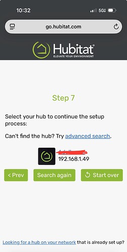

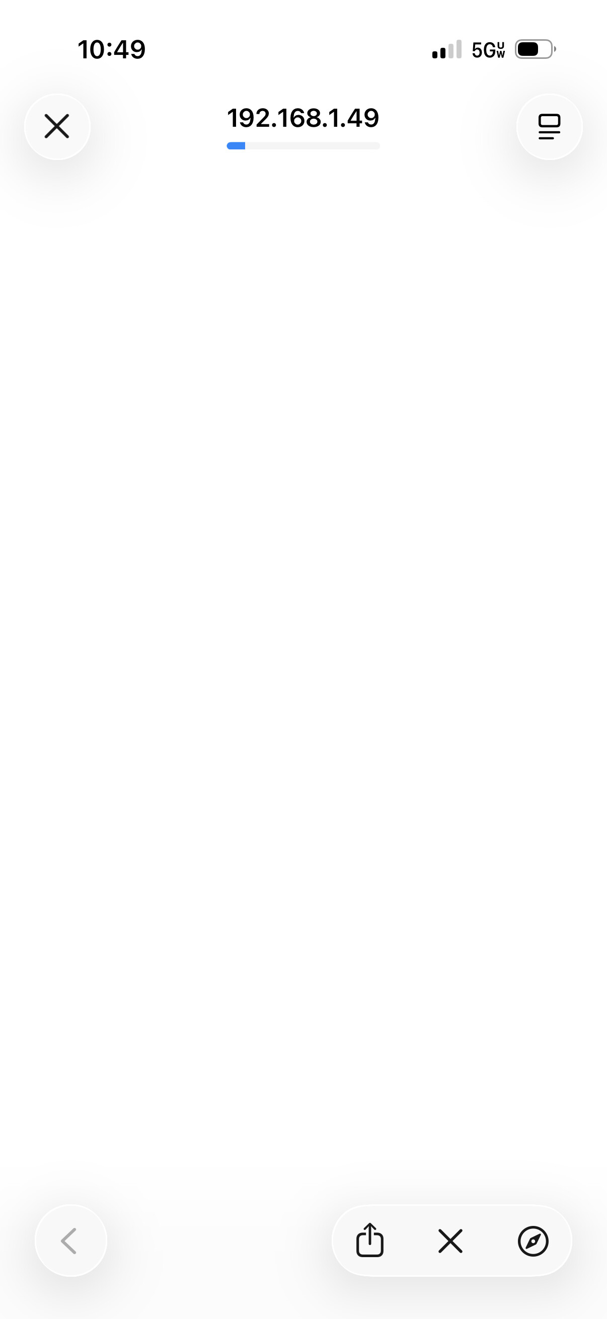

If I tap the link at the bottom of the screenshot, it brings me to the findmyhub page, which also has no trouble finding my hub:

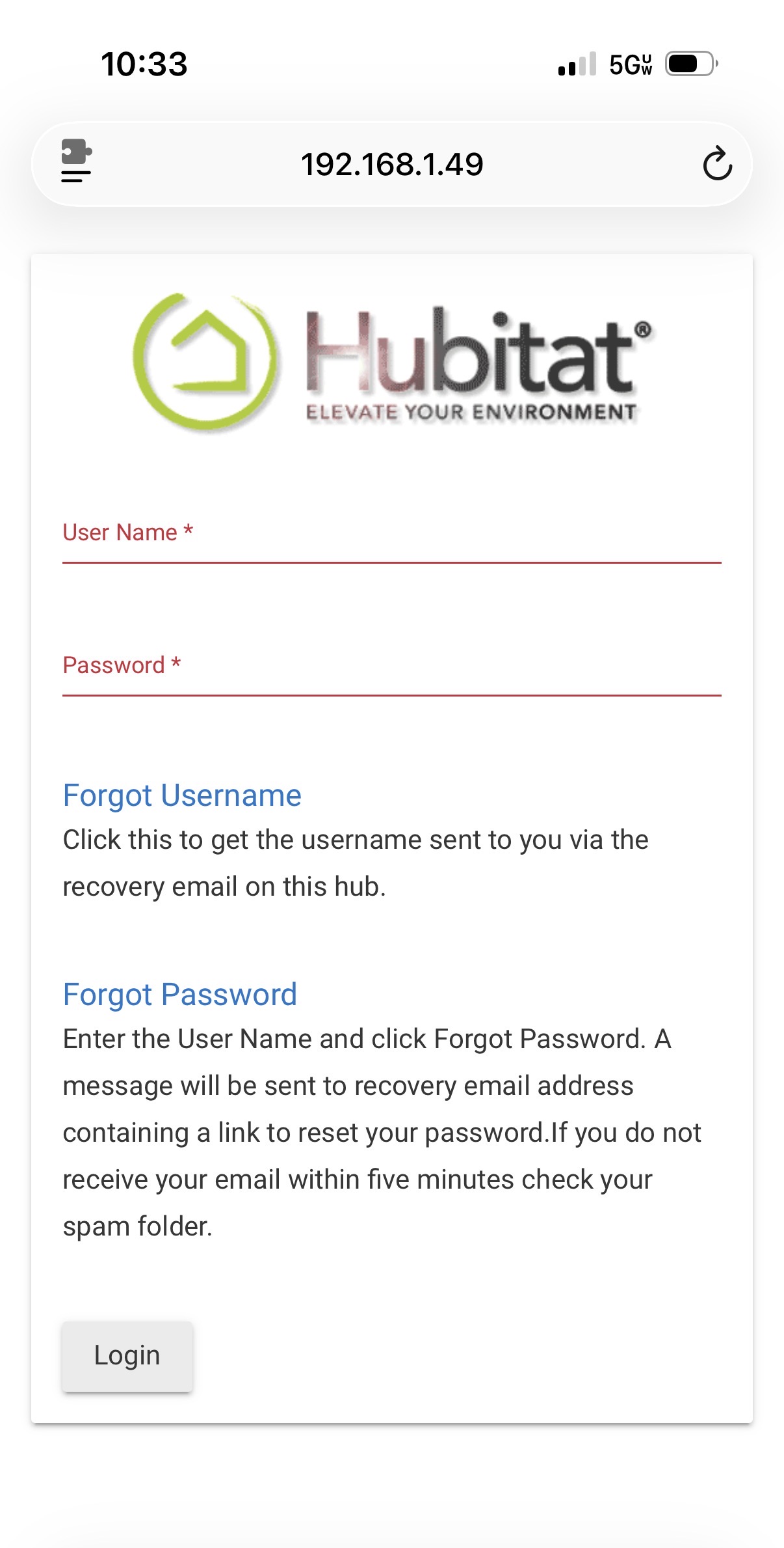

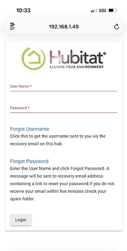

I can tap connect to hub, and here’s my hub, with its local IP address in the browser window (you can also see my phone connected to 5G, not my home WiFi):

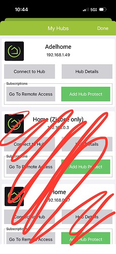

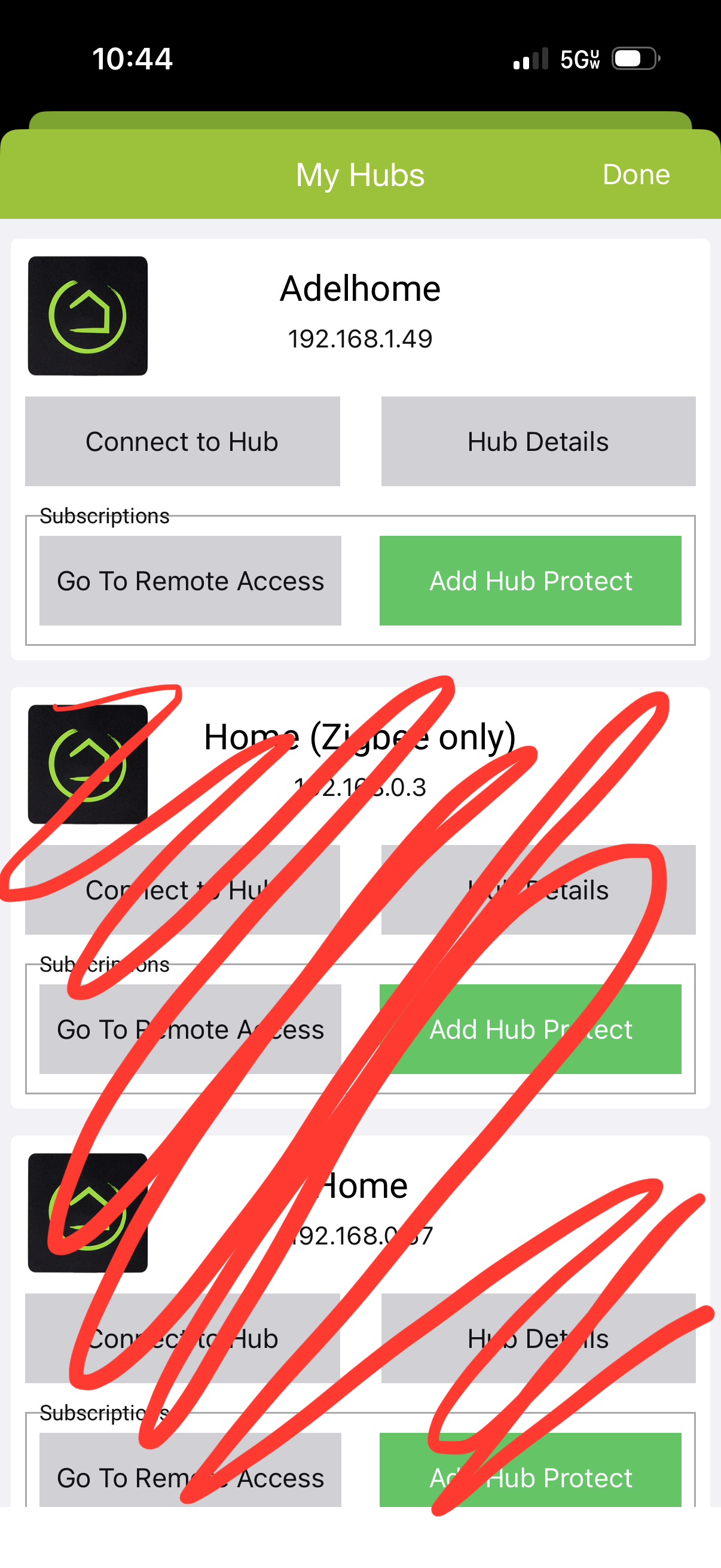

Here’s my hub in the list of registered hubs from the mobile app (ignore the other two in the list):

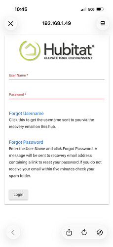

When I tap connect to hub, here it is again with its local IP address:
