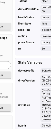

Sonoff SNZB-06P is supported in this driver :
Motion not responding: Always unknown
Is the device online / responding to ping() commands? (The screenshot is cut, and not everything is visible.)
Anything in the live logs?
Yes, ping try <100
Logs of debug logging
Anything that you want to see?
What is in the logs when you move away from the sensor for one minute and when you activate the sensor back...

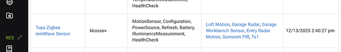

Did you install the driver for the first time now (because of the Sonoff sensor), or did you have a previous version installed before?
Make sure you have clicked on this button at least once:
The standard device profiles (used by all mmWave sensors) should have loaded automatically, but…
Had it for a while,but just updated to try this.
Please check the other mmWave devices - are they working OK after the update?
Loaded profiles.
Checking others now.
TS0225_LINPTECH works OK
