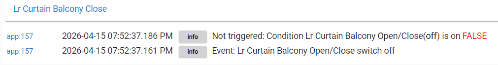

Just because it was true when the page in your screenshot was last refreshed doesn’t mean it was true at the time shown in the log.
It's not a bug, it's the same edge case we've been discussing from the start, where both the trigger and the condition are looking at the same attribute, and you expect one to be latched and not the other. IRM is just not designed to work like this and this is an edge case best dealt with a RE. It's an edge case because the general case is that the condition is looking at something different than the trigger and this WHOLE discussion becomes moot.

What you are REALLY saying is run rules only if the state is true AFTER THE EVENT OCCURS, not BEFORE the event occurs.
Generally you are correct.
But in the above case the Condition was 100% TRUE because only an Event itself was changing a Condition State.
I am clearly saing Run Actions if Condition is TRUE BEFORE the Event.
In you head, I’m sure, but that’s not what you wrote in RM ā€˜ā€™languageā€. RTFM
