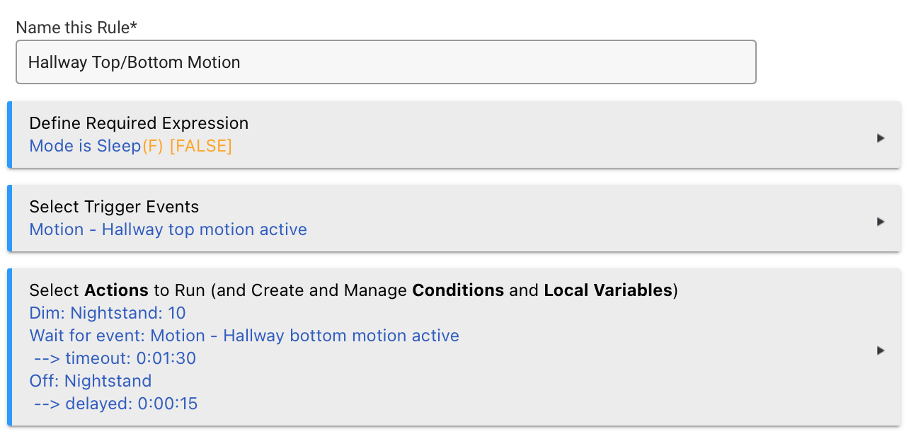

With all that said, your rule could be something as simple as the one pasted below.
  1. In Sleep Mode, when an upstairs motion sensor is triggered, my nightstand is turned on to a level of 10% (or dimmed from whatever level it is at to 10%).
  2. When a second motion sensor is triggered, the nightstand is turned off after a delay of 15 seconds.

I'll give your rule a try to see if this works for my case.
