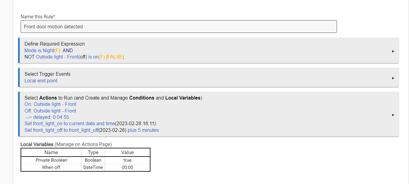

Probably don't need to. Can you post a screenshot of the rule?
Setting the variables is me trying things.
