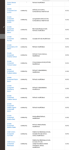

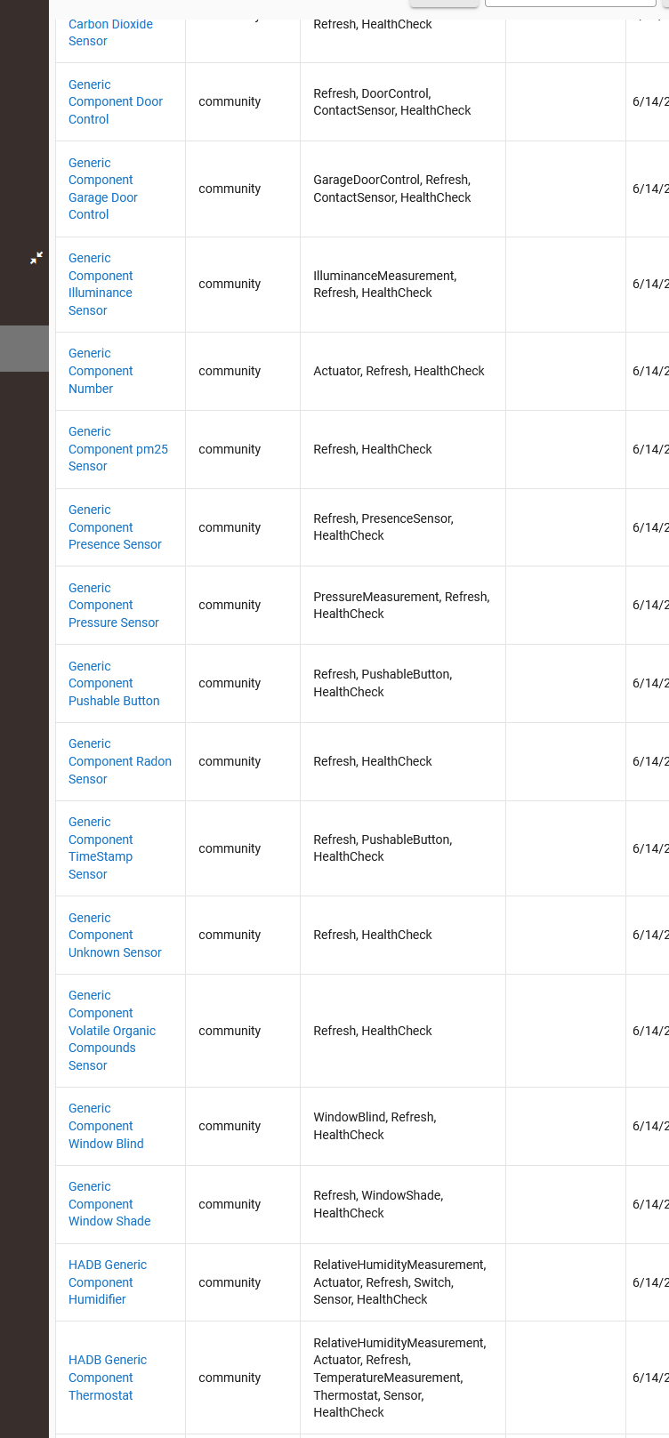

'community' drivers - do they come from Home Assistant bridge?
I recently (in the last 3-4 weeks) installed Home Assistant - I now find I have a plethora of 'Community' drivers I have no idea where they came from.
Does anyone recognize these and has an explanation about the source?
Most or all appear to, from a quick look. You can find a list of the drivers it installs in its HPM package manifest:
https://raw.githubusercontent.com/ymerj/HE-HA-control/main/packageManifest.json
(JSON format but should be pretty easy to read regardless.)
These are child drivers use by the bridge. I add HADB in front of the name of newer ones so they can be visually better associated with their origin. I don't think there is an effective way to change the older ones name in HPM.
They were recently all marked as required because there was too many errors related to missing child device drivers.
