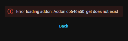

I click the link and get the error below. Any suggestions would be appreciated!
