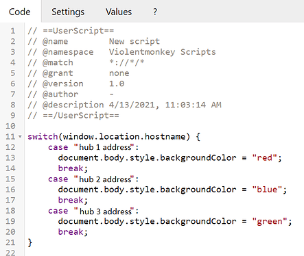

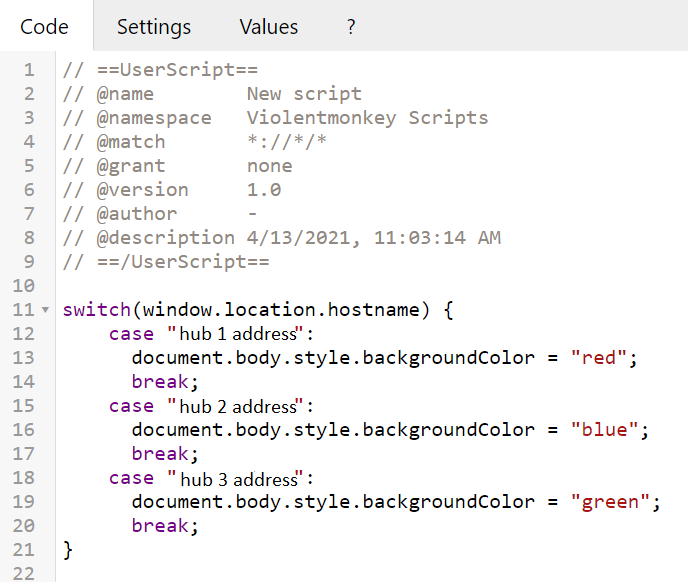

Just tried it - here is very simple script I wrote to test... seems to work.
Put the IP addresses of your hubs as needed.
switch(window.location.hostname) {
    case "10.0.0.1":
      document.body.style.backgroundColor = "red";
      break;
    case "10.0.0.2":
      document.body.style.backgroundColor = "blue";
      break;
    case "10.0.0.3":
      document.body.style.backgroundColor = "green";
      break;
