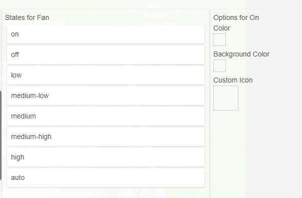

I have bond devices that control my ceiling fans. The fans are put on the dashboard as child devices for the bond units. Everything works just as it should. What I would like is for the square on the dashboard to change color to yellow when the fan is on, the way a switch works. Is this doable?
You just need to go into templates on the dashboard and set the colors for the speeds under the fan template. I think you can ignore setting speeds and just set on and off colors if you want. I like different colors for different speeds, though.
Perfect! Thank you. I had no idea that was there.
