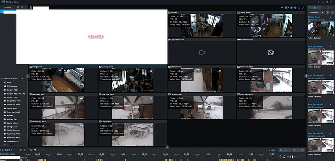

Hope everyone is staying warm and safe. For me cameras are good.
. Unfortunately although they are no longer tied directly into Hubitat (I had to remove them due to performance issues), I have motions sensors at each camera location that trip and turn on TV to see the trip using Hubitat RM.

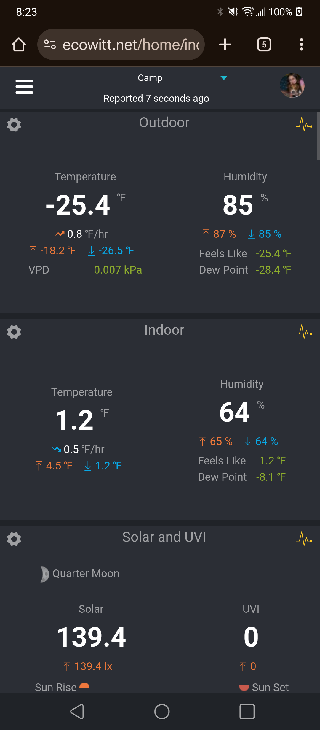

our cottage in u.p. mich
1.2 indoor temp?!! Dude.. your cottage is frozen!! lol
Wow! That humidity is kinda strange tho…
No, I don't think so. Cold air holds less water.
That's relative humidity. At this low temperature, 85% RH translate to a very small amount of water vapeur in the air.

My sensors show absolute humidity. That’s what confused me.
yep winterized and water turned off. I think humidity was high as it was snowing
What brand/model of humidity sensors are you using? All of mine are relative humidity, and thus I am curious what sensors you're using. :thinking:
that's the ecowitt wh31 or wh32 temp humidity sensors
