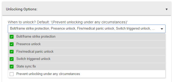

So I have a code question about enum. I am configuring a list of variables to be selected in an enum list in an app. What's the best way to determine if they are selected? I'm using integers to make the enumerations easier to code logic for later.
input "whenToUnlock", "enum", title: "When to unlock?  Default: '(Prevent unlocking under any circumstances)'",
options: [1:"${state.whenToUnlock1}",  2:"${state.whenToUnlock2}", 3:"${state.whenToUnlock3}", 4:"${state.whenToUnlock4}",
          5:"${state.whenToUnlock5}", 6:"${state.whenToUnlock6}"],defaultValue: 6, required: false, multiple: true

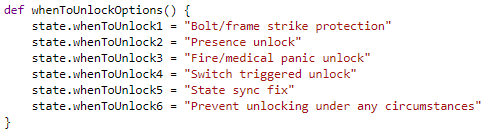

def whenToUnlockOptions() {
state.whenToUnlock1 = "Bolt/frame strike protection"
state.whenToUnlock2 = "Presence unlock"
state.whenToUnlock3 = "Fire/medical panic unlock"
state.whenToUnlock4 = "Switch triggered unlock"
state.whenToUnlock5 = "State sync fix"
state.whenToUnlock6 = "Prevent unlocking under any circumstances"
Options 1 through 5 are selected, and 6 is omitted. Enumerating for each I can see it outputs the ones that are selected so I'm almost done. Just need a little help with converting this to the simplest possible testable logic:

PS - While this is a matter of style, I wouldn't personally use state to store your "whenToUnlockOptions" options, unless you have a reason to do so, like if they change based on user input and you need to store those values. If you just want something more or less equivalent to constants you can reference at any point in your code, I'd recommend a static, @Field-annotated script variable (field, now) instead. Also, I believe your options for that input should be a list of Maps, not just a Map. Something like:
