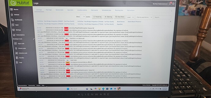

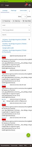

Cocohue integration quit working, i currently have 4 bridges and all dump back into HE used package manager to update and now when trying to select the app all 4 show unexpected error
Unfortunately, the actual error is cut off in your screenshot. Using a desktop or laptop (preferably one of these) or maybe just landscape mode on your phone may help.
But either way, I'm going to guess you have a mis-match of file versions. Did you do a manual update? If so, make sure you got both the app and all drivers and that you didn't accidentally overwrite one driver with a different driver (maybe restore from a backup and try again if you aren't sure). If you used HPM, try a repair to make it download everything again.

Well, did you use HPM to install it in the first place? :slight_smile: If not, it won't know unless you do a Match Up. If you installed it manually and mismatched drivers, however, a Match Up won't know the difference, and a subsequent repair won't help because it will reinstall whatever is mismatched as still mismatched.
Your error suggests what I guessed above, one or more app and driver files being updated when not all the others were. A manual update is prone to this if you are not careful. I'd suggest using the bundle ZIP if you go that way, though individually can work, too. In particular, make sure you got the app and bridge driver code updated, though they will all matter at some point. HPM makes this easier.
