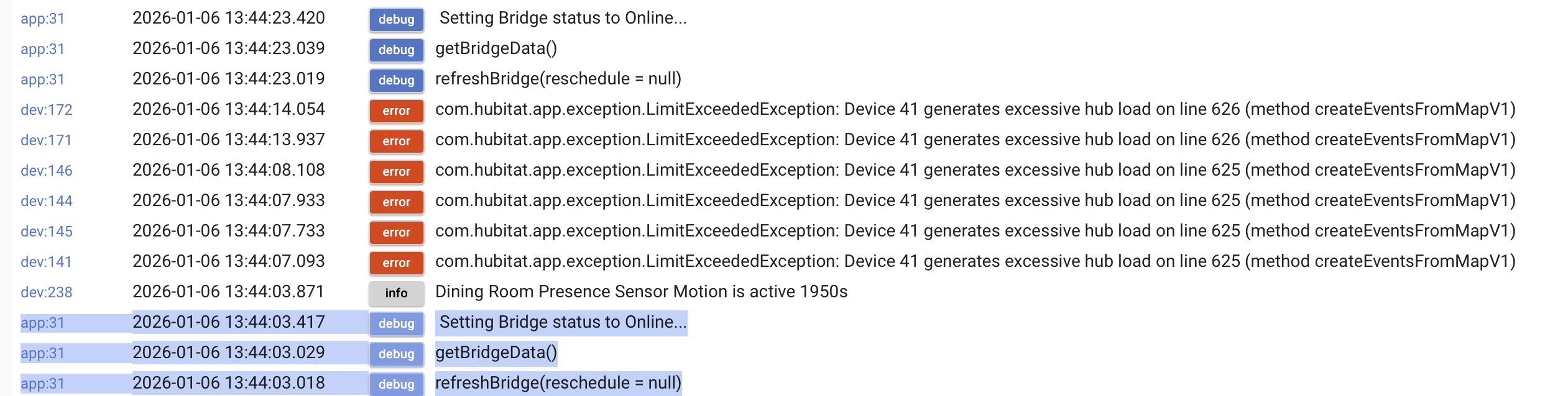

I was checking my logs this morning and I saw I had a large number of errors I think for every hue device attached via CocoHue
Device 41 is the CocHub Bridge. It is still seeing the bridge and sending/receiving.

That is the solution when you see this error. Often the driver/app being targeted by the error is not what is actually causing the problem, it is just what is trying to run.
Error is common if the hub reaches uptime over 60 days I have found, typically as you get closer to 90 days uptime.

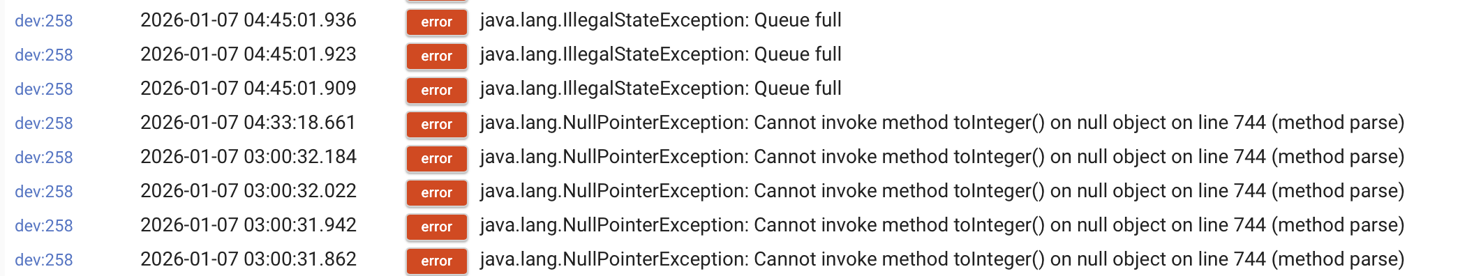

Looking through the log I am also seeing a Java Error on the Hue matter bridge
java.lang.NullPointerException: Cannot invoke method toInteger() on null object on line 744 (method parse)
I am not sure if this is connected or not or what is causing this

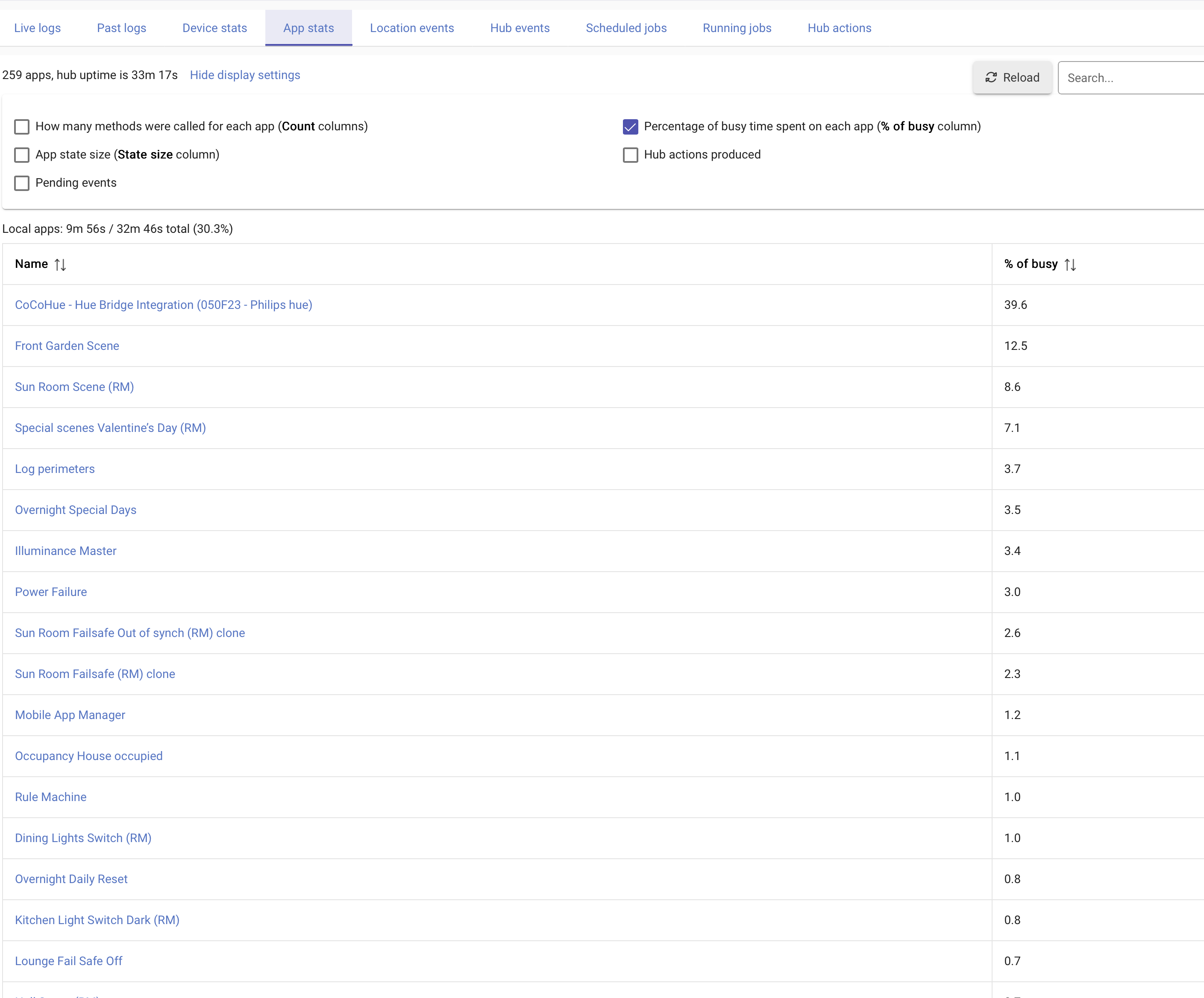

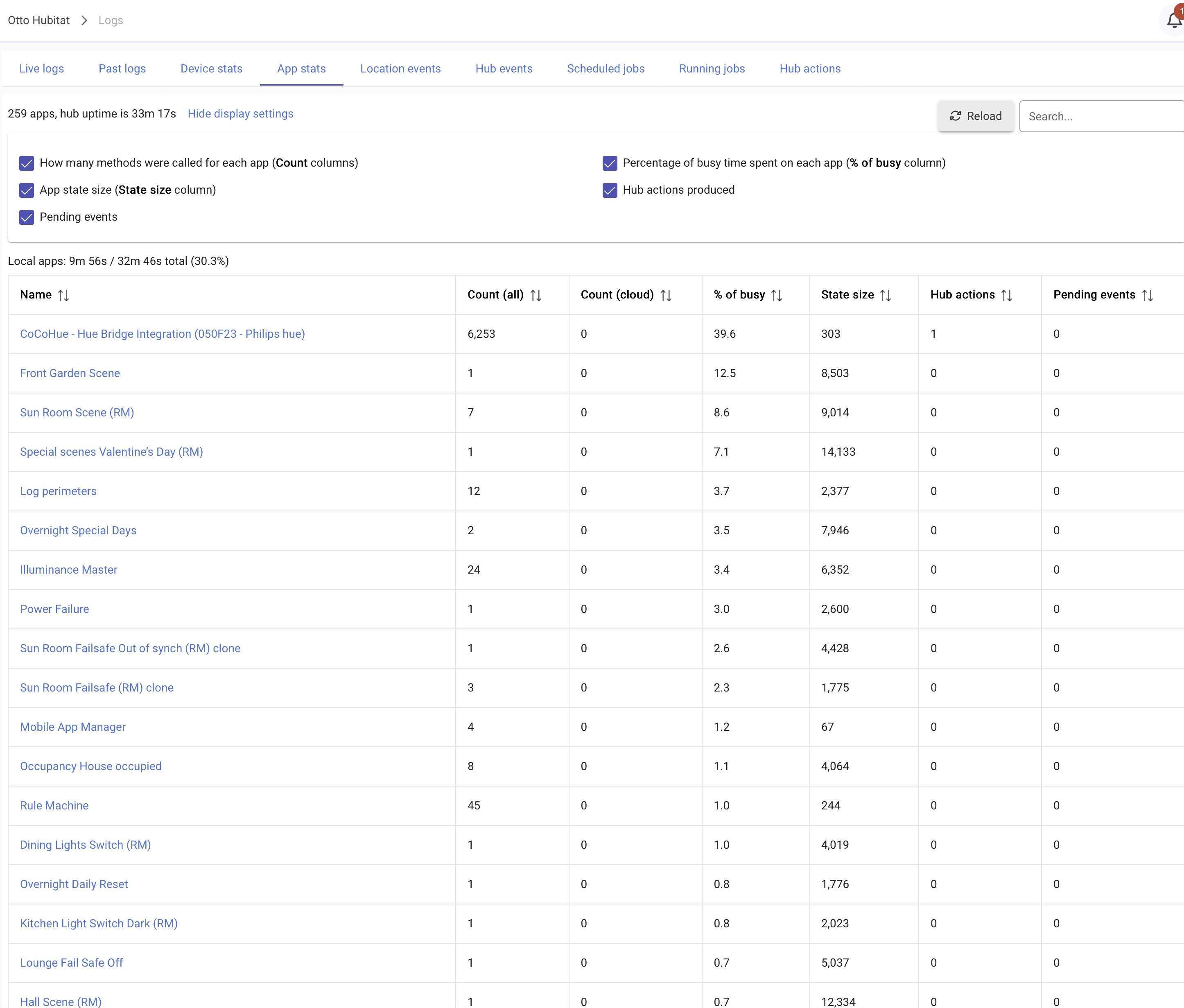

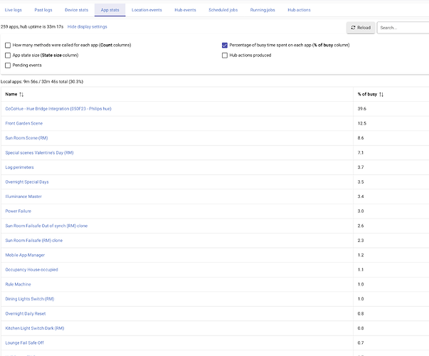

Let the hub run for some time after a reboot, or wait until you start getting errors. Go to Logs > App Stats (and Device Stats). Make sure all display settings are enabled. Should be sorted by %busy highest to lowest by default. Get a screenshot of the top however many fit on the screen, including the stats up top showing the uptime. Get that for both pages.

screen shots taken when both were turned on
Here is the apps one again as I selected the wrong screenshot
It does look like your CoCoHue has gone bonkers.

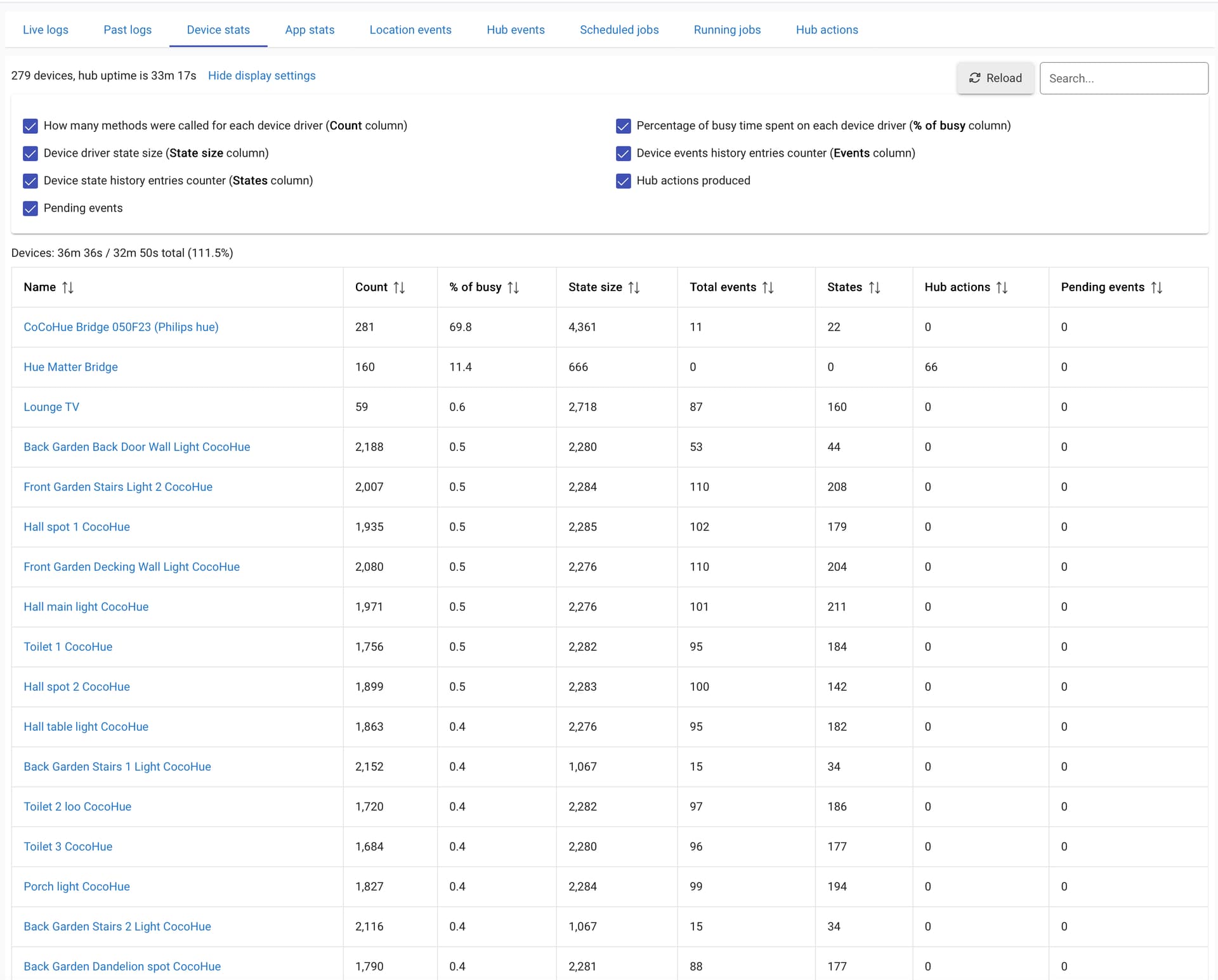

With polling turned off these are the stats.

I am now getting
After a bunch of Null Pointer cannot invoke calls it now seems to just give the illegal state exception. This may be the byproduct of turning off the devices. However I am not seeing the flood of CocoHue excessive load alerts I previously got when I just turned off the Matter Bridge and CocoHue apps. So I will turn on the Hue Matter Bridge and CocHue apps, leaving off the HomeKit Bridge to see what happens

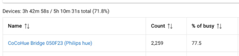

It is something with the CoCoHue bridge (device). If you look at these stats from when you had polling off, still the hub was busy 71% of 5h with devices, and of that time 77% was taken up by the Hue Bridge.
Here is what is more typical. Total device time is less than 1%
