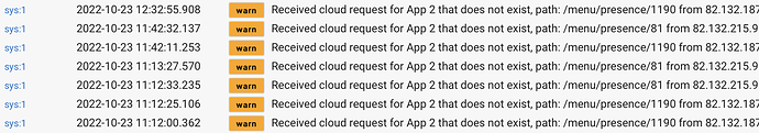

I'm not sure what is causing the cloud requests in the below logs. Is there anyway I can identify it, so that I can stop the requests? The only thing I can think of is that they are coming from Locative, but I deleted everything within the app and also deleted the maker api instance to which it pointed.

There are 2. I purposely chopped the end off in case it shouldn’t be posted. I’m out at the moment but will check again when I get back. I didn’t do a Whois search but doubt it would reveal much

I've checked the IP addresses and both belong to my phone network O2 UK. Switched off the WiFi on mine and my wife's phone and checked the public address - it's hers! So I guess it's the Hubitat app that's trying to connect but although it's on her phone for presence, I'm not sure why the log is referring to connection to an app that doesn't exist.
If you had a dashboard with presence tile that you since removed, the mobile app is trying to post the phone presence. Logging out of the mobile app and back in should resolve the problem.
Thanks @bobbyD - that did the trick.
In the Hubitat app on my wife's phone, selecting 'send geo event' resulted in two log entries 'Clare Has Arrived' for her phone device and the previously detailed error for the hub. I logged out and back in again as suggested and the error is no longer logged - just the 'arrived' message.
